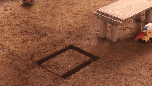

Step 1: Excavation

Now Use a shovel or Pipe to dig a hole at the marked location. Dig down to the required depth, which will depend on the size and design of the pillar as well as the soil conditions. The hole should be wider than the diameter of the pillar base to allow for proper placement and backfilling.
