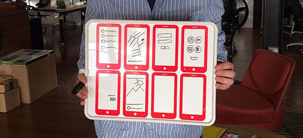

Have a mobile app idea? Take your idea to the next step by drawing out the various screens. This kind of low-fi prototyping can help you refine your idea without even needing to write code or design anything. I made one of these for my Code for America fellowship team.

Step 1: Design Your File
Depending on the size of your whiteboard, you'll want to design your sticker sheet to fit the right number of screens. I chose to use the iPhone 5S screen size and my whiteboard fit two rows of four screens. You could also experiment and include some tablet and desktop sizes, if you'd like. To keep it simple I just used 8 iPhone 5S sizes.

Step 5: Add Your First Row of Stickers to the Whiteboard
Open up your whiteboard and remove any stickers put on it when you purchased it. Peel the contact paper off your newly created vinyl stickers. Your vinyl design should stick to the clear contact paper. Position and place your sticker sheet on your whiteboard. Smooth it out to make sure you don't have any air bubbles under the stickers. I used a sharpie to roll out air bubbles.
Step 6: Add Your Second Sticker Sheet
Peel off your second sticker sheet and adhere it to the whiteboard. This is straight forward, but a little challenging to line it up correctly. You really only get one shot at it, so be careful! Remember to smooth it out after placing the sticker.
Step 7: Draw Out Your App Ideas
Draw a lot, erase, change, draw another one. If you like what you came up with, you can snap a quick photo of the board before you erase it.
