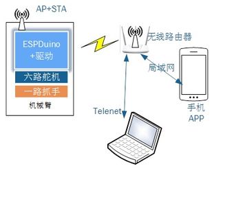

(4) human-computer interaction by Telnet
When we set up a Telnet servo by using ESPduino to realize the function of the human-computer interaction, and then control the robot arm and state display.

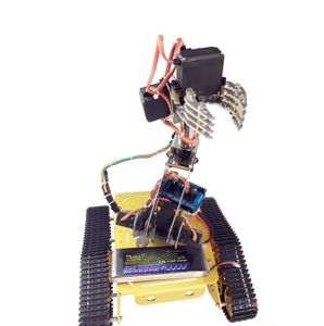

DoArm robot arm is shown in Figure 2. Robot arm is controlled by the ESPduino and driven board by the WiFi between ESPduino and router. By this way, robot arm can be controlled by the PC or APP in mobile phone.

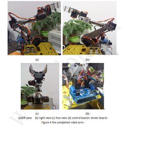

After install the metal robot arm and tank chassis, in the next
step, we should install the ESPduino developbaord kit. Then, let the servo extension cable connect to the driven board. If the servo extension cable isn’t too long, can be connected by dupont cable, and insert into the board. Certainly, we can assign the channel randomly, the can decide the setting channel by the program. The completed mobile robot arm is shown in Figure 4.

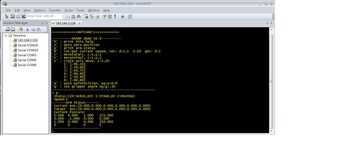

Since ESPduino is already built-in the Telnet function, we can realize the Human-computer interaction, check the running-state, current position, the current velocity, and so on, by Telnet. At the same time, we can set the movement model for the single or multi-axis, and movement location.
When ESPduino connects to the wireless router, PC can connect the IP address of ESPduino by Telnet Tools (such as, SecureCRT). The connect port is 23, which is shown in Figure 6.
By Telnet, we can control the robot arm by
the following commands, which are defined as follows.
“h”: print the help information;
“z”: let the axises of robot arm return to zero location (i.e., the default initial location defined in the above sections), which are defined when we set up the D-H matrix. Then after power, the objection location is 0 for each axis, as shown in Figure 7.

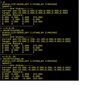

“p”: print the current state of the robot
arm, as shown in the following picture. The information includes state, setting velocity, current angle for each axis, object angle, and current position matrix for the end actuator.
“d”: check or set the current velocity, of which, the velocity grade is defined as 1~10, where “1” is the lowest velocity, and “10” is the fastest velocity.
“c”: keep the current position for the end actuator, and then let actuator move along with the x-axis, y-axis, and z-axis in Cartesian coordinates, respectively. The unite is mm.
“t”: keep the current position for the actuator, and then let actuator move along with the x-axis, y-axis, and z-axis in Tool coordinates, respectively. The unite is mm.
“s”: single-axis movement. At the beginning, each axis is at the zero location, and the angle is defined as 0, the scope is -90 degree~90 degree. The positive and negative is decided by right hand rule.
“w”: move to the designed location.
“g”: control the gripper (paw). For example, g:45 is meant to let the paw open 45 degree angle by control the servo.

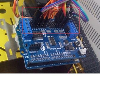

When you connect the servo extension cable to the driven board randomly, firstly, we must let each axis of robot arm is corresponding to the channel on the driven board, respectively. Then, confirm the excursion for the zero location; finally, confirm the permitted-moving scope.
(1) Confirm the channel number on the driven board for each robotic arm
When you connect the servo extension cable to the driven board, it is very difficult to differentiate the number corresponding to the channel number on the board. Therefore, we just insert the servo extension cable to the board randomly, as shown in Figure 8.
Figure 8 Servo extension cable on the driven board

let arm.setChannel() be the actual access channel. As shown in Figure 8, the access channel is 1,3,4,9,11,13, respectively, then let
arm.setChannel(1, 3, 4, 9, 11, 13);

Then, we can get the final right corresponding relation between the axis for the robot arm and the channel on the driven board, as shown in the following function.
arm.setChannel(11, 9, 13, 4, 1, 3);

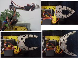

(4) Control for gripper
The control for gripper is separate to the other 6 axises, so we can use “g:x” command to control the gripper, as shown in Figure 11.
(a) Position for gripper at 0 degree
(b) Position for gripper at 20 degree
(c) Position for gripper at 45 degree
Figure 11 control for gripper

The inverse kinematics function calcReverseKinematics() can be provided to compute the designed position and reverse angle position for the robot arm end actuator. Especially, Telnet interaction provides the command along with x, y, z axis in the Cartesian coordinates; i.e., “c:x,y,z”, where x,y,z denotes the increasement along with x, y, z axis with unite mm and float type.
For example, if let end actuator move 20mm along with z axis, the command is “c:0,0,20”, and then return “c:0,0,-20”. The robot arm would move 20mm in vertical orientation, and then move 20mm in the reverse orientation. Finally, the arm would return to the original location. At this time, the location is zero. When received the command “c:0,0,20”, the location is (0.000,2.358,-11.361,0.000,9.003,0.000); after this, if run the command “c:0,0,-20”, the location is (0.000, -0.000, 0.000, 0.000, -0.000, 0.000), as shown in Figure 13.
Figure 13 Movement in Cartesian coordinates
