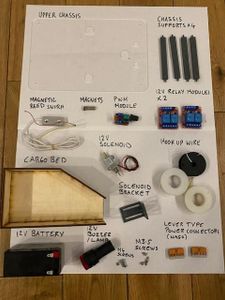

Here's a list of materials and tools I used to build the mobile robot.
Main Robot Materials
- Siemens LOGO 12/24V PLC
- Siemens LOGO 12/24V PLC I/O Expansion Module
- Upper Chassis 3mm plywood laser cut
- Lower Chassis 3mm clear acrylic
- Chassis Supports x 4 3D Printed PLA
- Robot Wheels & Gearmotor x 4 (available on Ebay and Amazon)
- Cargo bed 3mm plywood laser cut
- 12V Solenoid (I got mine from the pi hut)
- Solenoid bracket 3D Printed PLA
- Infrared sensors x 2 (Available from CPC Farnell DFROBOT)
- Ultrasonic sensor HC-SR04
- PWM Motor Speed Adjustment Module (Ebay)
- Magnetic Reed Switch
- Magnets
- 12V Relay Modules x 2
- Start / Stop buttons Spring Return x 2 (not shown in picture)
- Hook-up Wire (I used 22 AWG)
- Electrical Terminals - I used Wago's
- Solder
- 3.5mm screws x 4
- 4mm screws and nuts x 2

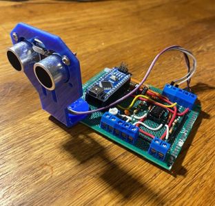

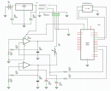

This mobile robot is equipped with an ultrasonic distance sensor to detect if anyone gets in the way of the robot. If a person, animal or object comes close the PLC activates a flashing light and sounder but keeps moving. If however the person, animal or object continues to get closer then the robot will stop and not move until the obstruction has moved.
I am using the analogue signal for this function. Ultrasonic sensors used in industry usually output 0-10V or 4-20mA and can be directly fed into the PLC. These sensors are often very expensive and are not appropriate for this project. Instead I am using a cheap HC-SR04 ultrasonic sensor and converting the signal from it to 0-10VDC using and Arduino and Op Amp.
The The Arduino outputs a PWM signal depending on the distance the object is from the ultrasonic sensor. I have averaged a running total of 5 readings from the HC-SR04 ultrasonic sensor to give a smoother output. A capacitor and resistor smooths out the PWM signal giving a 0-5VDC signal. This signal is then amplified to 0-10VDC by the OP Amp so that it can be used by the PLC. I have included a schematic of the PCB I built together with the Arduino sketch showing how the distance sensing is converted for use with the PLC.

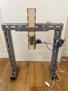

Step 3: Ping Pong Ball Depositor With Tinkercad
The Robot in this project is designed to do work in the same way that an industrial robot would in a factory, a farm, a hospital or any other situation you can think of. This robot is designed to collect ping pong balls from a location and deliver them to another location. This means the robot is part of a bigger system and when it gets to a set location on it's travels it enables another machine to deposit a ping pong ball into it's cargo hold.
A magnet in the track causes the robot to stop for a few seconds when the cargo hold is below the pin pong ball depositor. It also has a magnet on the robot that causes the pin pong ball depositor to operate and release one pin pong ball into the cargo hold.
The ping pong ball depositor uses two linear solenoid actuators in a tube of ping pong balls. When the sequence is called to operate the lower solenoid retracts and releases a pin pong ball. A second solenoid is mounted 40mm higher and is simultaneously called to extend which holds the other balls in place. After a set period of time (3 seconds) the lower solenoid returns to being extended and the upper solenoid retracts. This loads another ball ready for the next time it is called.

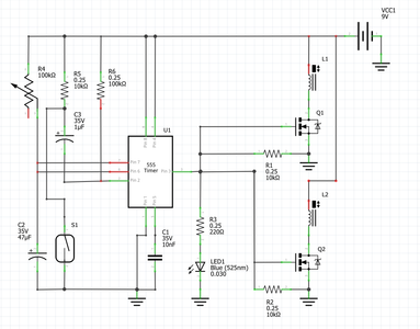

I decided to not use a microcontroller for this process it can be done simply with a 555 Timer IC working as an edge triggered monostable. An edge-triggered monostable 555 timer operates as a one-shot pulse generator. When triggered by a falling edge signal, it produces a single output pulse of fixed duration even if the input to the 555 is held low after the cycle is completed.
The way this circuit works is as that initially, the 555 timer's output is low. Upon trigger, the internal flip-flop sets, causing the output to go high. Simultaneously, the 555 internal discharge transistor is activated, and the timing capacitor charges through an external resistor. Once the capacitor voltage reaches a threshold, the flip-flop resets, driving the output low. The time the pulse is held high is determined by the resistor and capacitor values. Subsequent triggers during the pulse have no effect because the trigger is activated by draining a capacitor on the trigger pin on the 555 timer. However another resistor connected to positive voltage almost immediately makes the trigger pin to go high causing the edge triggering effect.
I used Tinkercad to design and simulate this circuit. This is the first time I have used Tinkercad and found it very easy to use. I have included a video of the design and a simulation of the circuit using the Tinkercad simulation mode. The great thing about Tinkercad is that it also automatically creates a Bill of Materials (BOM) and schematic design that I have attached.

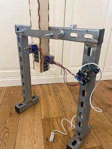

I made a laser cut tube for holding the ping pong balls and mounted the tube using industrial channel 40mm x 40mm galvanised steel channel. This type of channel is commonly used in industry and often referred to as "unistrut" which is a trade name.
I used Fusion 360 to design the brackets that mount the two linear solenoid actuators and then used Fusion 360 to export the design to a .stl file which I could then 3D print.
