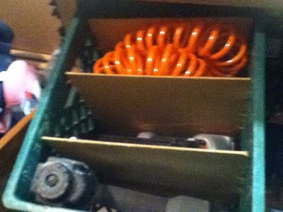

Next some modified milk crates for storage bins. They are divided with thin sheets of MDF cut to fit and attached by drilling holes along the side and zip tied in place.
