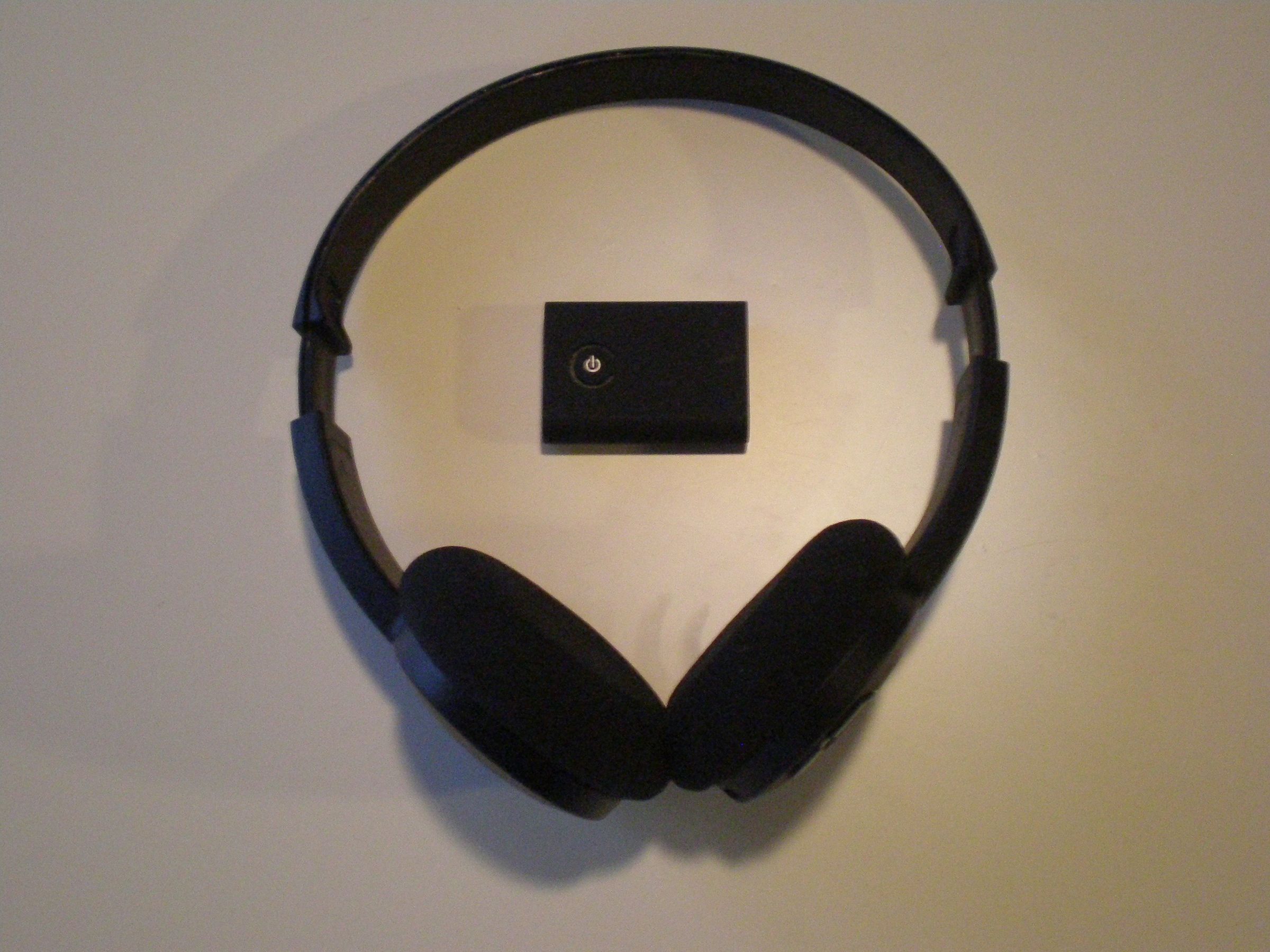

Bluetooth headphones (A2DP)
Universal Bluetooth Adapter*

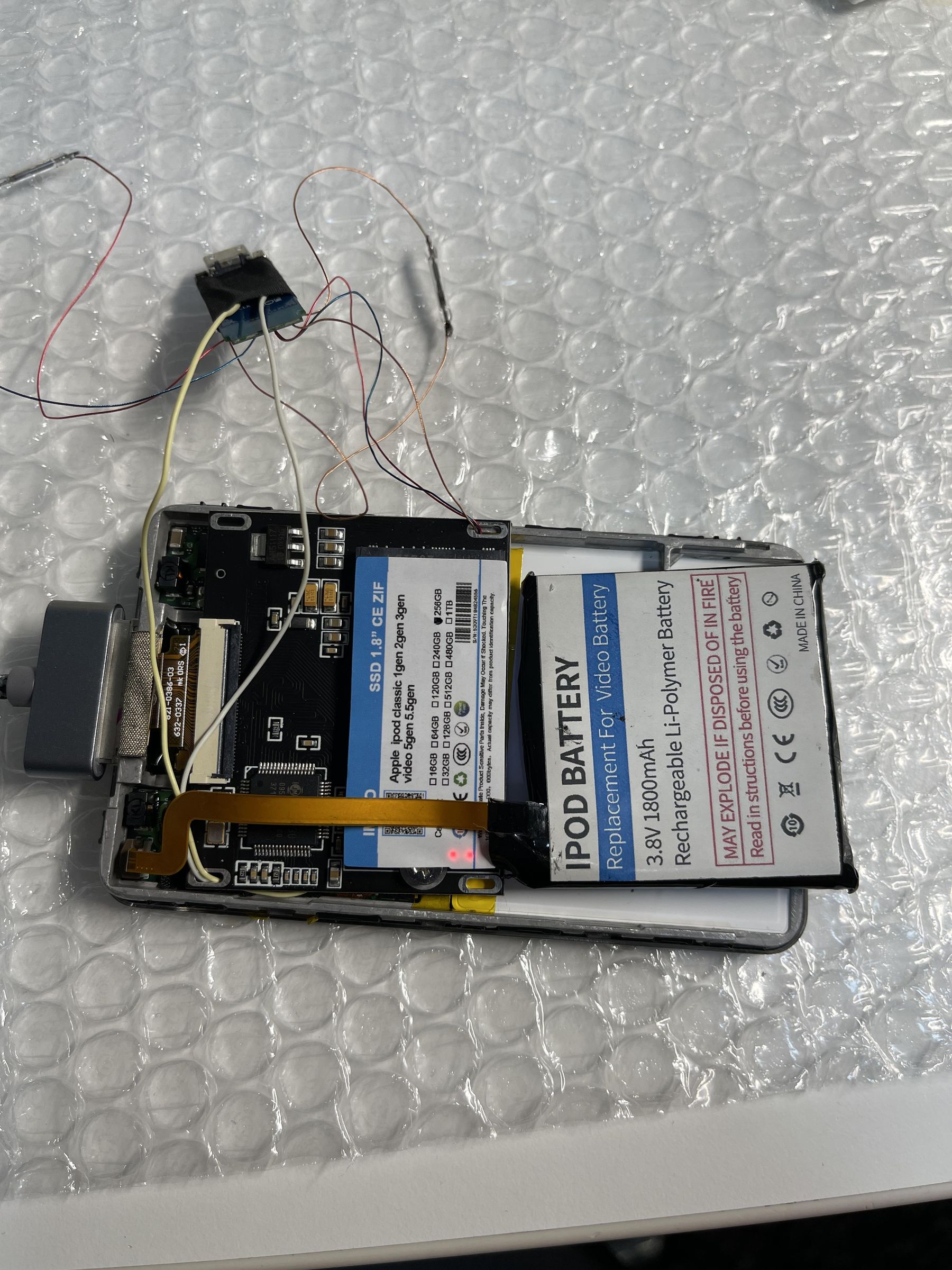

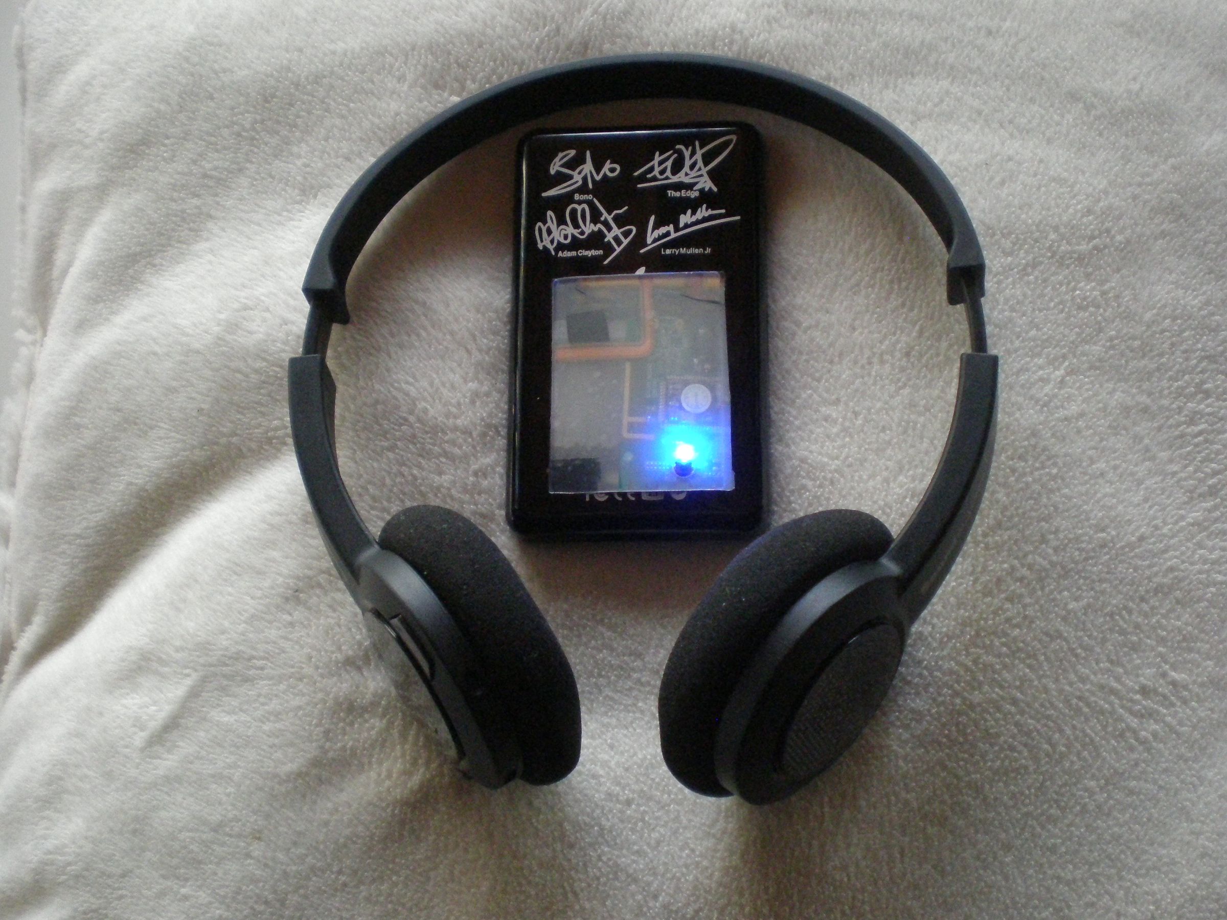

There have been a lot of questions regarding the type of Bluetooth module used in this mod. Just about any universal module will work, some will be easier than others to wire up. Don't use a dock-based module, finding the correct connections in it will be extremely difficult.
Unlike my 4th Gen BT hack, here I used an older module from Billionton mainly due to its small size. Another difference between the two is that in the Jabra and others like it, you will need to either pair it before you close up the case or allow for a way to access the module's switch.

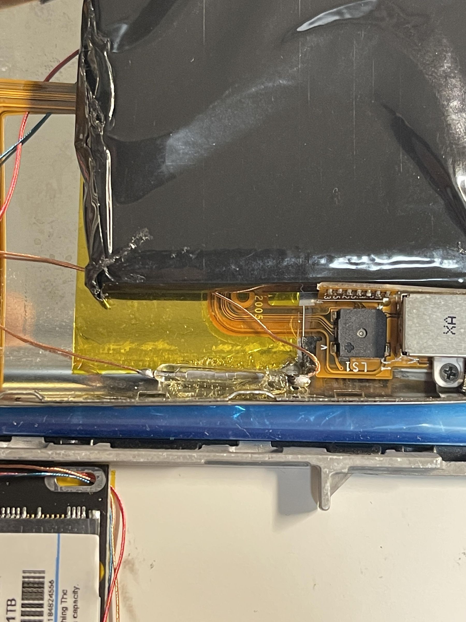

Prepare the BT module as shown and solder the power and audio terminals to the appropriate locations on the ipod. If you want a status LED, you'll want to solder leads to the SMT LED pads so that you can route your LED to the frame.
Notice that you will likely need to flatten the "bubble" part of the LED to make it fit into the frame without sticking out too much.
Step 6: Reassembly
Once you have wired up the BT module, install the CF adapter. Carefuly thread the BT power, ground, LED and audio leads around the CF adapter and position it as shown. Use a little bit of tape to keep things in place. You might also want to glue down your wires so they don't break off.
The kind of wire you use also makes a big difference. If the wires are too large, you will have trouble closing the case. I used wire wrap wire the first time around but found it was too fragile and kept having to repair broken connections. 28g or 30g "soft" wire works best.
Step 7: Test & Restore
Carefully put the iPod pieces back together but don't snap closed just yet.
Plug your iPod into the PC using the dock connector. If iTunes does not automatically open up, do so now.
If you're also installing a CF card, iTunes should recognize your iPod and will give you the option to restore the iPod to its original settings. Click OK and wait for it to finish. The pictures below show you what to expect during the restore process.
If you're keeping your HD or have already gone through the restore process, go ahead and test out the BT functionality: Turn on your headphones and set to pairing mode. Turn on your iPod, make sure the LED status light is on. Play a song on the iPod and pair with the headphones. The pairing process will be different for different modules, so see your BT module manual for specifics on this.

Can you please tell me where the power and ground go to? I have my board all wired up, have completed the flash card upgrade, just finished tribooting IPL, RockBox and the Original FW. All I need now is to know where to solder the power and ground because I can't find my multimeter anywhere and really don't have the money to go spend $30+ on a new one.
0
wvufan8866
wvufan8866
11 years ago on Step 8
where does the ground for the audio go to on the ipod? and where do the ground and power go to on the ipod that were on the top right of the bluetooth mb?
0
pledpfldfpldfp
pledpfldfpldfp
Reply 11 years ago on Step 8
I second this request. This guide is useless because it leaves out these 2 critical steps. They show you disassembly, reassembly, but leave out where you actually solder the bluetooth power and audio wires. PLEASE FIX THIS GUIDE. IT IS USELESS IN IT'S CURRENT STATE!!
0
fstedie
fstedie
No need for insults, this instructable is not useless, tons of people have successfully modded their ipods with this guide.
As for the power & ground, it was left out on purpose.  If you can't figure out where to solder these two then you probably shouldn't be doing it...
