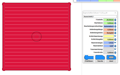

                  Next I had to draw the pocket for the clockwork, which was 56mm x 56mm and also the hole for the 8mm shaft.
                  After I finished my drawings, I went ahead with my CAM software and did the toolpaths.
                  Keep in mind to set the correct depth values and don't forget to clear the corners of the pocket!
                  I set the depths of the "numbers" in the crossbar to 2mm.
                  The Pocket for the clockwork was 20mm
                  The other toolpaths have to go all the way through the material.

                  I started with the crossboard and milled the Pocket for the mechanic clockwork.
                  Please keep in Mind to mill the pocket into the back of the board!
                  I first marked the center of the board with about 1/3 of the overall length (79cm / 3=26,33cm) from the left.
                  That was my "Zero" for the Pocket.
                  I then milled a Pocket with 56x56mm and a depth of 23mm and drilled a hole of 8mm diameter in the middle.
                  The pocket came out quite nice, but I did a quick Sanding paper finish to clean out everything.
