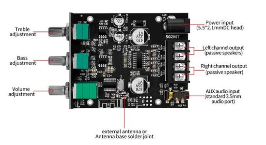

Step 1: ZK-502MT 2.0 Stereo Bluetooth Amplifier Board
We're using the ZK-502MT Stereo Bluetooth amplifier board that features the CS8663E which is a high-efficiency Class D audio amplifier IC designed for stereo and mono applications. It’s especially popular in DIY audio builds due to its simplicity and performance.
Its standout feature is the ability to deliver 2 × 50 W of clean Class D output, making it ideal for powering medium- to high-wattage speakers with minimal heat and high efficiency.
It supports both Bluetooth and AUX input, giving users flexible connectivity, and includes manual bass and treble adjustment knobs for real-time tone control without external EQ modules.
With a wide operating voltage range (9V–24V) and built-in protection circuits, it’s engineered for reliability and ease of integration into custom enclosures—perfect for makers building portable or embedded audio devices.

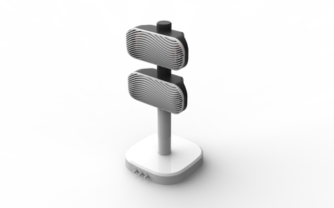

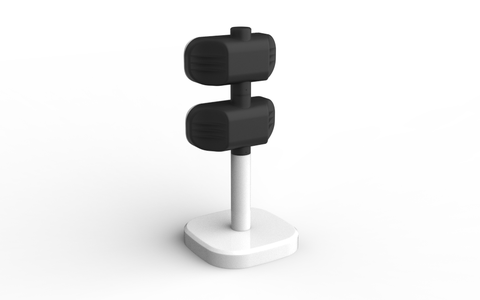

We kicked off this project by rethinking the design from the ground up. The goal was to break away from the conventional boxy speaker format—which dominates most designs and frankly feels uninspired. Instead of sticking to that rigid shape, we wanted to explore something more dynamic and visually engaging.
Our design starts with a central base that houses the audio module and battery. From there, the speaker units are mounted externally and connected to the base via a pipe-like structure. This connecting pipe plays a key role: it not only physically links the speaker bodies to the base but also cleverly conceals the wiring.

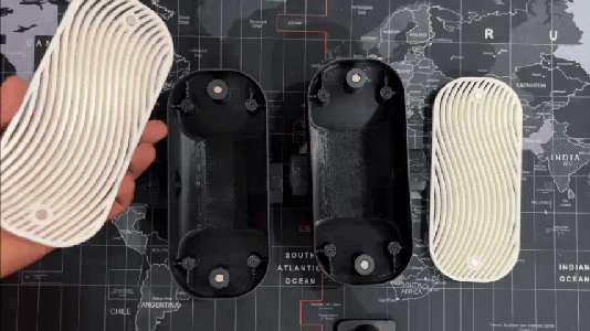

Each speaker is enclosed in a custom shell, split into two nearly identical halves—Speaker 1 and Speaker 2. Inside each half, we’ve added screw bosses for securing the drivers with M2 screws, along with a dedicated boss for embedding magnets. These magnets allow us to snap on the front mesh cleanly and securely.

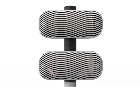

To elevate the visual appeal, we designed the front mesh with a flowing, wave-like pattern. This detail gives the speaker a distinct character and helps it stand out from traditional designs.
SOUND BOX
Step 4: MODULARITY

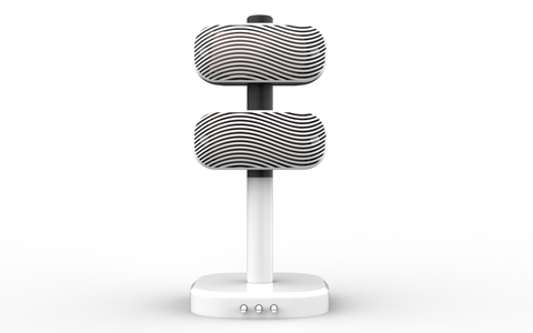

One of the standout features of our build is its modular speaker holder design, which allows us to easily double the number of speakers if needed. The setup includes two speaker holders connected by a pipe-like structure. Speaker 1 nests into Speaker 2 through this connecting pipe, and by repeating the Speaker 2 housing, we can scale the system from a 2-speaker setup to a 4-speaker array.
The beauty of this approach is that Speaker 1 remains unchanged, while Speaker 2’s enclosure can be duplicated as many times as needed to boost sound output. For our current version, we’ve kept it simple with a standard 2-speaker configuration—but the design is ready to expand whenever we want more punch.

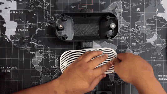

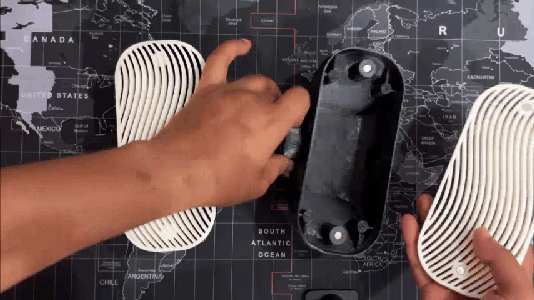

Step 6: MAGNETIC FRONT GRILL ASSEMBLY

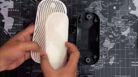

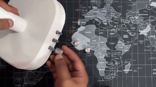

  1. We kicked off the build by installing magnets into the designated bosses on both Speaker 1 and Speaker 2 bodies. Each magnet was oriented with the North pole facing inward, so it sits flush inside the enclosure.
  2. Next, we added magnets to the front grill, this time with the South pole facing into the grill bosses. This polarity setup ensures that the grill snaps neatly onto the speaker body and stays securely in place, held by magnetic force.
  3. At last we push Speaker Body 1 into Speaker body 2 and this concludes our first part of assembly.

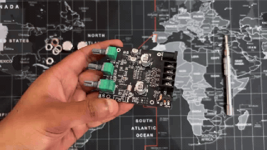

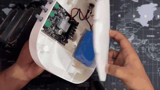

  1. The Pipe like part is now push-fitted in its position from the inside of Base Body, then tightened in place using four M2 screws.
  2. Audio board is then placed over its mounting position. and then tighten in place using four M2 screws.

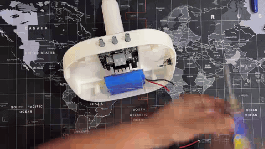

Step 10: POWER SOURCE ASSEMBLY
  1. We began the power setup by securing the 12V battery pack inside the base using hot glue.
  2. The battery’s positive terminal was connected to the cathode of the IN5399 diode, and from there, another wire ran from the diode’s cathode to the DC IN of the audio board.
  3. The battery’s negative terminal was wired to the DC barrel jack’s ground, and an additional wire from that same ground point connected to the GND pin on the audio board.
Once all connections were made, we plugged in a DC adapter to the barrel jack—and the indicator LED lit up, confirming that the charging circuit was functioning properly. To verify that the audio board was receiving power, we turned the potentiometer knob to the ON position, which activated the board and lit up its onboard LED.

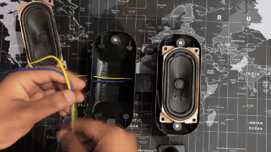

Step 11: SPEAKER SECTION ASSEMBLY

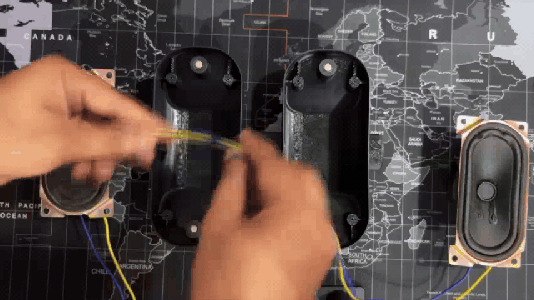

  1. Now comes the speaker assembly process; here we are using these rectangular 8-ohm 10 W speakers for this build.
  2. We start the assembly by first adding wires to both speakers' positive and negative terminals.
  3. we pass the wire of the first speaker through the joint part of the Speaker 1 and Speaker 2 body and then place both speakers in their position over their mounting screw bosses. The M2 screw is then used to secure both speakers with the speaker 1 and speaker 2 bodies.
  4. At last, we added an additional M2 screw on the backside of the joint between both speaker bodies; this screw will keep both speaker 1 and speaker 2 locked together so they can't rotate in place.

The magnetic grill system worked flawlessly—snapping into place with satisfying precision and holding firm without any mechanical fasteners. The modular speaker holders proved their worth too: while I started with a 2-speaker setup, the design is ready to scale up to 4 speakers whenever I want more volume or wider coverage.
Visually, the wave-patterned front mesh and dual-tone print (White and Black Hyper PLA) give ModiFi a distinct, polished look that stands out on any desk.
