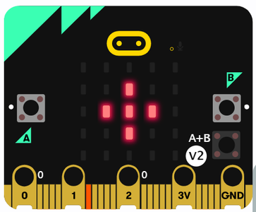

Setting the clock.
Before setting the clock ensure that the RTC has a battery fitted to retain the time when/if power is removed.
The default time format is 24 hour mode.
Move the switch to the set time position a plus symbol will be shown on the display.
Press Button A for Hours. (0 to 23)
Press Button B for Minutes. (0 to 59)
Press Buttons A & B together to set the time, the entered time values will be displayed.
Move the switch from the set position.
