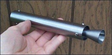

Before we begin, we must define the components used. The motor for the rocket, will be the B200 KNDX (Potassium Nitrate and Dextrose based propellant) designed by Richard Nakka. Its has a thrust of 1157 Newtons, which makes it fall into the "H" class. It weighs around 400 grams when loaded with the propellant and has a burn time of 0.38 seconds.

- The motor retainers are locked into place by the B200's screws. Some electrical tape can be applied to create a tight fit. The top retainer of the motor, is hold in place by the screws used on the second cylinder from the bottom.
