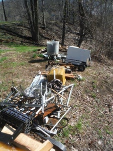

Step 1: The Great Gathering of Materials
Most of the materials for this project I had laying around or were harvested from the local thrift store along the way.
Step 2: Stripping Down an Electric Wheelchair.
I was lucky enough to get a used electric wheelchair at a reasonable cost. I removed the seat and all non essential parts for later use.

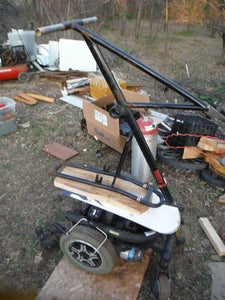

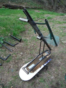

Step 3: Base Frame Construction.
I made the base and the underlying skeleton out of an old stationary bike, half a snowboard, and some lumber.

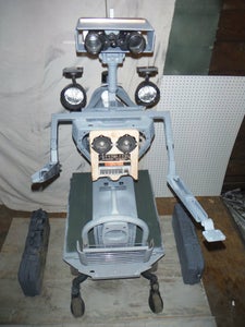

Step 6: Finishing Up Assembly.
In these pictures are the final putting together of all of the pieces for the platform. The two boxes on eather side of the robot are for tool/project storage and are removeable.
