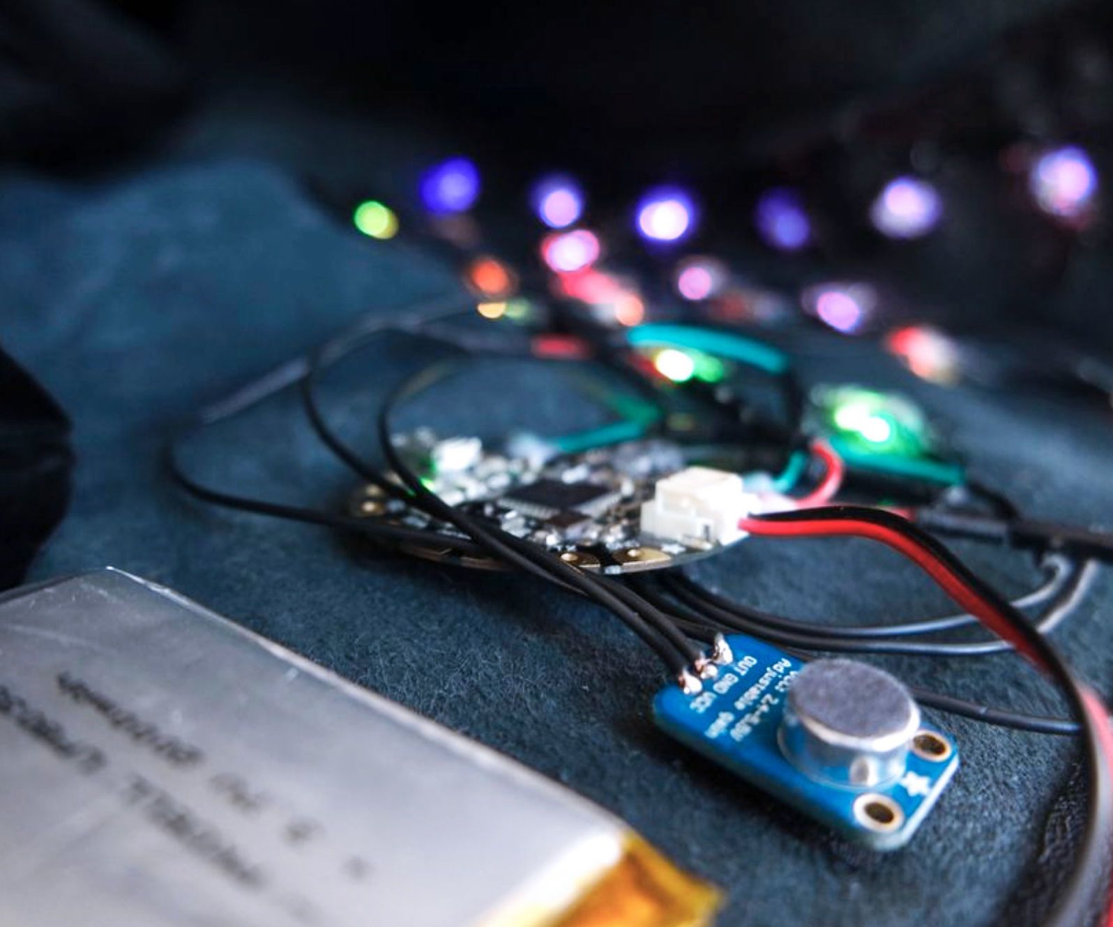

Before soldering all the electronic components onto a 'Perma-Proto Half-sized Breadboard' use a normal breadboard for testing your electronics first. Connect the heart rate monitor, button and LEDs to the photon pins defined in the code. Stick the electrodes to your body like shown in the picture, ensuring the electrodes match the correct pins. Now you can open the photon serial monitor and get your heart beat data over you local WiFi.
If you want to see the EKG diagram on your monitor you have to download Processing. In Processing, open the sketch in the processing folder and run the sketch by clicking on the arrow in the left corner. If everything is set up correctly, a window will open up and you can see the activity of your heart. It helps moving as little as possible and it takes a while until the biosignal is steady enough for a clean visualization. For more information and/or troubleshooting check out Sparkfun's Heart Rate Monitor Guide. You might have to modify the line in the sketch which contains Serial.list()[3] and change the number to whichever port your serial monitor is on. If you're unsure of the number, try 0 through 6.
Step 17: Solder Onto Perma-Proto
To connect our custom integrated e-textile electrodes with the board, and not the bulky sticky electrodes, solder a header onto each of the RA (right arm), LA (left arm) and RL (right leg) pins on the board.
If everything works, you can solder the components on a perma-proto board. I started with the photon, then the wires followed by the heart rate monitor in the end. Instead of soldering the three LED wires permanently onto the board, I used three (Data, VCC and GND) male jumper wires to connect them with the LED wires.
A 5V power bank as a power supply works great for the photon because it's rechargeable. You can also use it for charging other electronic devices like your smartphone.
