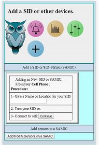

Once everything is assembled and powered up, using your cell phone or a PC with Wi Fi connection, go to smartioteck.net.
  • Click the 'Register New Account' near the bottom of the page.
  • After you finish registering login and you will see the dashboard.
  • Click the Blue (+) plus icon to add your SID station (SAMIC) into the system.
  • Follow the instructions in the first section.
In my case I called my IOT monitor 'Room Monitor' . then I pressed 'continue' and followed the instructions.
Once your system is set-up, then you come back to this page and click the button in the second section to add sensors. The monitor is programmed to handle over 12 different sensors. You basically select in 4 boxes with sensor you have plugged in, and you are ready to go.
On the dashboard, the green button-icon let you make changes to the range to your profile, i.e., the two emails to send alarm to. and changes to the alarm range of the sensor, for example at what temperature you want red or yellow alarm.
