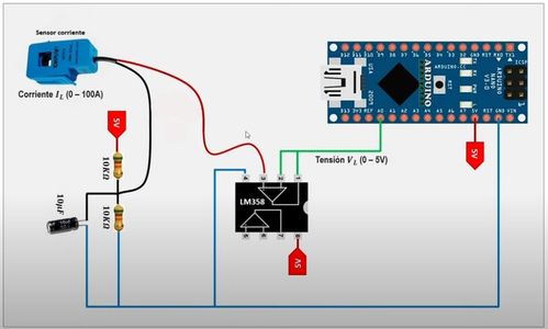

  3. Electrical current: RMS calculation with an SCT-50A sensor.

❗The SCT-50A sensor should be calibrated using an alternating current (AC) consumption device with a known or previously measured consumption, which will allow the calibration value to be adjusted to obtain accurate readings.

  9. Current sensor: Measure AC up to 50A.
  10. x1 Sensor SCT-50A: To measure electric current.
  11. x2 Resistors: 10kohm.
  12. x1 Capacitor: 10uF.
  13. x1 Integrated circuit LM358.
  14. x1 3.5mm. female jack connector compatible for the SCT.

  17. x2 Resistors: 100kohm for the voltage divider.
