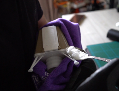

The design of the model is based on Vikram Lander by Indian Space Research Organisation. The spacecraft was launched on its mission to the Moon on 22 July 2019 However, the lander crashed when it deviated from its intended trajectory while attempting to land on 6 September 2019. I have given up a few details for easy 3Dprinting.
Lander model is 3D printed. You will need a glue gun to stick the legs. Using screws for everything was making the model complicated and increased the 3D printing time so it's easier this way. All files can be downloaded from grabcad.
Grabcad has a neat feature to let you see and explode the full 3d model on the browser itself. Please use it if you get confused about how to assemble the lander.
Download cad files from here
Note:-
If you do not have access to 3D printer no problem you can use a plastic coca-cola botel cut it in the middle and paint from outside. Electronics don't take up that much space. Just make sure you stick the sensor firmly otherwise it will have false readings. Cardboard is also a good alternative.

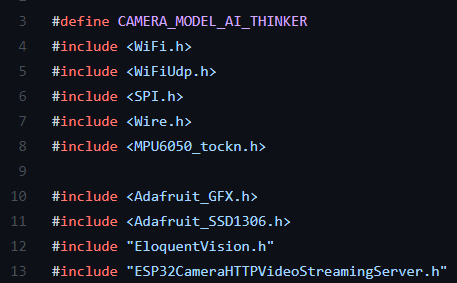

Step 3: Installing Libraries
Before compiling and uploading the program we need to install the libraries for both Arduino and Processing IDE.
Most of them can be found by simply searching on the library manager. Here are some links to help you install everything.

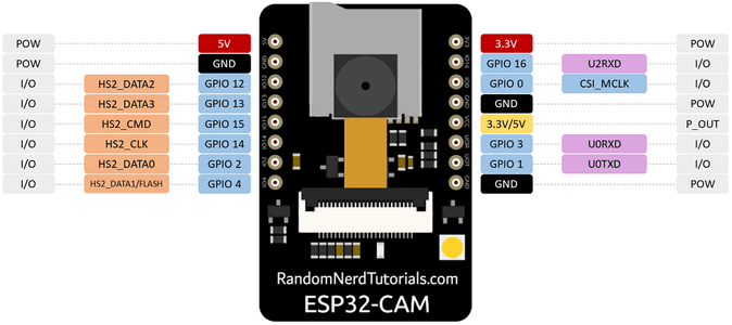

Step 4: Wiring
Wiring is very simple. Both MPU6050 and Oled screen use an I2C bus and have to be connected to the same pins. You will need a pinout diagram of esp32 to this. We will not use default I2C pins on esp32 instead we will use software I2C bus pin(14,15). For some reason, default I2C pins were not working on mine so I choose this method. Please refer to the diagram above.
Battery and Power
Everything runs on 5-volts however there is no 5-volt battery unless you are using a power bank. Most people will use a 9V battery but you cannot power the board directly with it you will fry the board. So we need to step down the voltage to 5Volts using a small converter or a buck.
You can use a 3-Volt Ni-cad battery also to power the whole thing.
--------DO NOT GO ABOVE 5VOLTS---------
Step 5: Programming ESP32-CAM
ESP32-CAM works like an Arduino but it's a little tricky to program because it does not have a USB port onboard so we will have to use a programming cable. ESP32-CAM is also not listed on the default board list on Arduino software so we will have to add it there. So please follow the link below on how to do all this.
Install ESP32 boards on Arduino IDE
Upload code on ESP32-CAM

Step 7: Code for Lander
Code is heavily commented on and can be downloaded from GitHub.
Please make the following changes to make it work with your wifi network.
