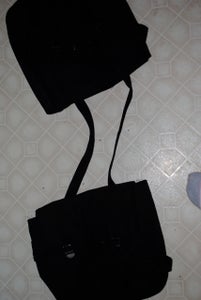

Step 2: Measure
I for whatever reason did not get any photos of this step. But its easy to describe what i did. My bags had canvas straps on them. I had to cut the straps off of one bag and then sew the strap from the other bag to this bag. To know where to attach them i had to measure on the bike and mark the strap. The strap should be sewn to the same spot that you removed the previous strap from. To measure i lifted my seat up and had my wife help me hold the two bags against the bike in the location i wanted them to hang when completed. I then used chalk to mark on the strap where i needed to sew it to the other bag. Now we can go and sew.
Step 3: Sewing
Now we sew. If you have a machine this part will be pretty easy. If not you will be sewing by hand. I find thick material like this is no fun to sew by hand. I have not used a sewing machine in many many many years. My wife helped me out here as i did not want my first attempt at sewing in a few decades to destroy her machine.

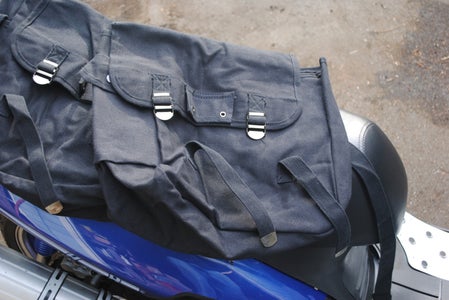

Sew the straps using the chalk lines you created in the last step to the bag that you removed the straps from. When done you should have your bags pretty much done. As seen in the photo for the measure step.

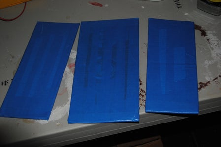

Step 4: Reinforcements

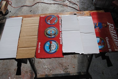

So for the reinforcements i used cardboard left over from a package i was about to send out to recycle. The reinforcements are optional and on some bags wont be needed. On my bags they keep the bags square like vs. just flapping in the wind. I started by cutting a piece to fit the bottom of each bag and then a piece for the two sides front and back. I did not bother with the front and rear faces as the sides do a good job of keeping the shape. After this i coated them with masking tape just to help stiffen the cardboard up. You can of course use other material than cardboard but the concept is the same. After doing this i used industrial velcro to attach the cardboard to the inside of the bags to keep the cardboard in place.
Really all you need to do now is put the bags on the scooter.

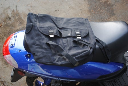

Ok so your pretty much done. Now you put them on and ride. I did use Velcro to attach the bags to the bike to keep them down while they are empty and im riding. Lift your seat up lay the straps down and make sure you are clearing any exhaust or other items that get hot and put your seat down and you now have some pretty wicked and super cheap saddlebags on your scooter.
