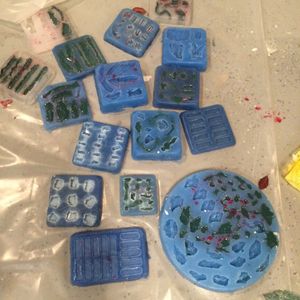

Step 4: Making Molds and Casting Mosaic Pieces.
1. Background.
For the background i needed about 2000 casted pieces of wrigley chewing gum. I used the actual wrigley chewing gum sticks to make molds. I arranged gum sticks on the backing pan and pored Dragon skin FX Pro Silicon over them. After 6 hours, i took the gum out of silicon and cleaned the mold. I used Insta Cast Polyurethane Resin to pour into this mold because this type of resin captures more detail. The only problem with polyurethane resin is that it yellows really quickly and so i decided to paint pieces after i grouted the mosaic. Since i used grout for the background in my mosaic, i had to cover every casted piece with 2 layers of latex to protect pieces from grout clogging.
2. Figures.
For figures i needed various shapes and colors. I used all the gum shapes i could find. I also crushed pieces, chewed them, let them out on the sun to melt, etc. After i collected all the needed shapes i made molds with silicon. The same process as with the background pieces. I used Polyester Resin and added resin dyes and acrylic paint to resin before i pored it into molds. There are some jewelry polyester resins that are non yellowing. Those resins are significantly more expensive. The regular polyester casting resin yellows at slow rate. I used non yellowing resin only for white and clear pieces and the rest was made with regular polyester resin.

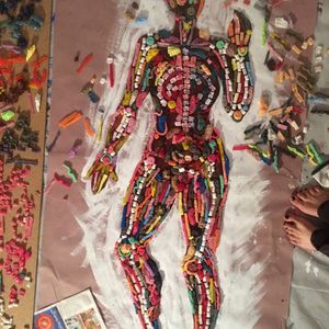

Step 6: Figure Assembly
First, i assembled pieced laying them onto the figure transferred from the sketch. Then, i protected the existing mosaic on the panel with plastic. I taped plastic around the figure to make sure acrylic that i use to embed pieces will not seep through. Then i transferred pieced onto the panel to make sure the design fits in the figure shape. I prepared a batch of acrylic color mixed with acrylic gel medium and transferred it into a plastic ziplock back. The final step is embedding pieces into the prepared acrylic gel. I worked on a small section at a time. I removed small section out of the shape assembling it very similar to the way it was inside the shape. Then i squeezed prepared acrylic gel out of the bag, smoother it with pallet knife and very carefully placed mosaic pieces back into the shape. After everything was in place, i could press pieces deeper into acrylic.
