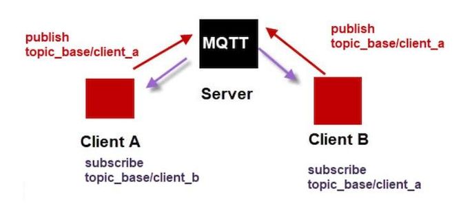

Whenever there is a pub-sub model used as a message communication protocol, we require a broker that can transfer the information in the required device. This can be done by sending the message under correct topic.
Let us understand this -
  • A Broker is a runtime server (continuously running service), which can have 2 types of clients - Publisher (seller) & Subscriber (buyer)
  • For instance, when a seller sells a product through a broker to a buyer, then it is using the Broker's service to reach & find a secured buyer.
  • Similarly, when publisher publishes a piece of information, the data reaches to the subscriber through the Broker.
  • The broker is responsible for having specific storage space where it can expect data from the publisher to store temporarily and then send to the subscriber.
  • In the pub-sub MQTT, clients talk to each other through an MQTT broker.

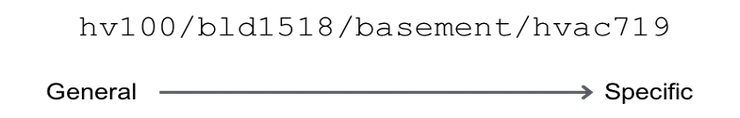

In the above command, if you noticed, I did not subscribe to a specific topic. As per the topics we published (from ESP32), like "schoolofiot/gap", "schoolofiot/temperature" or "schoolofiot/humidity".
  • The reason is, gap, temperature & humidity comes under the general topic of schoolofiot level. So, to access/view any data published as a sub-level of schoolofiot, we can use '#'.
  • Apart from this, in case we need to subscribe to a specific topic (like temperature), we can use command like this -
> .\mosquitto_sub -h test.mosquitto.org -t "schoolofiot/temperature"
Therefore, no matter what name is put under the general topic, we can subscribe to it and view all of them together.
