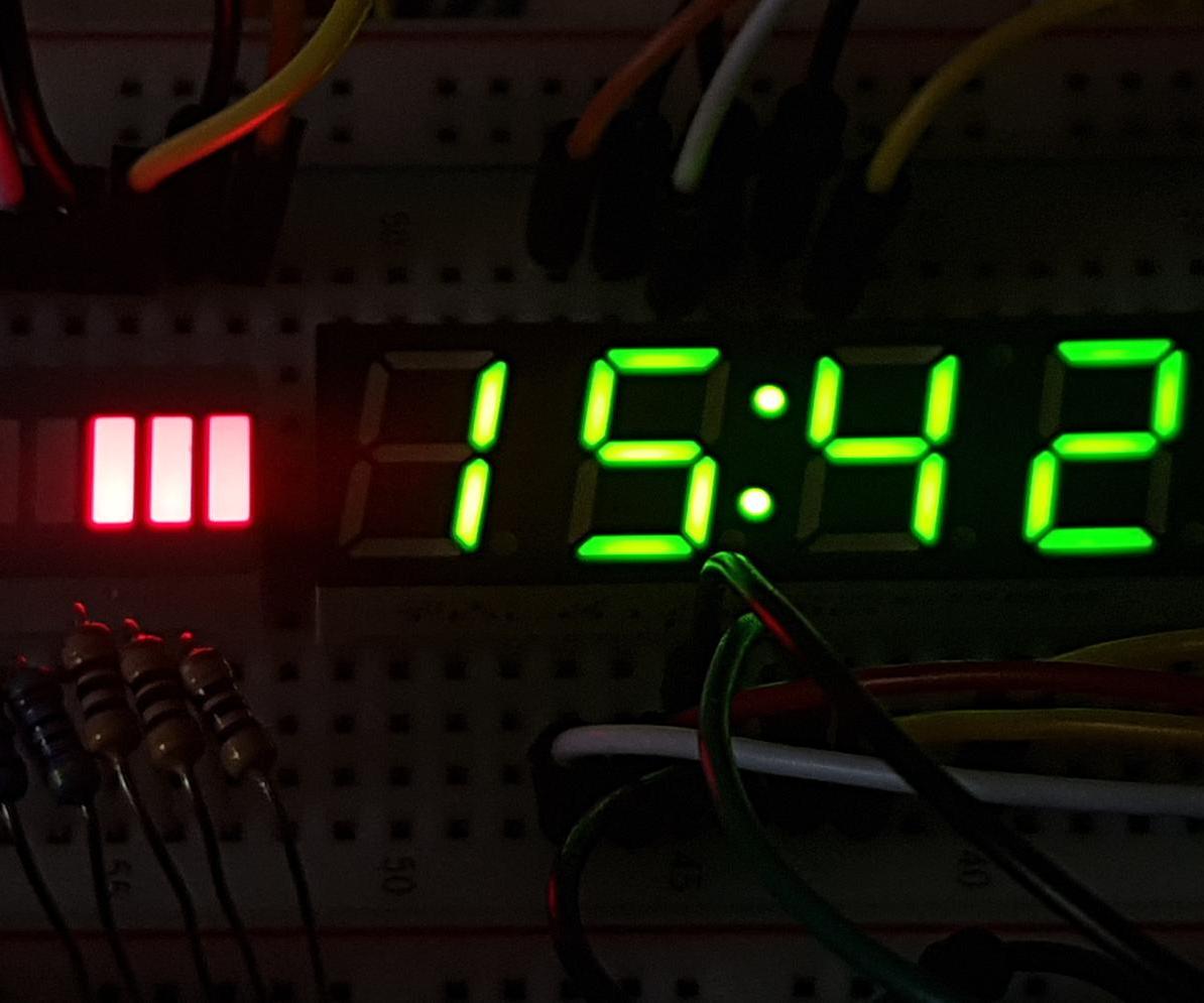

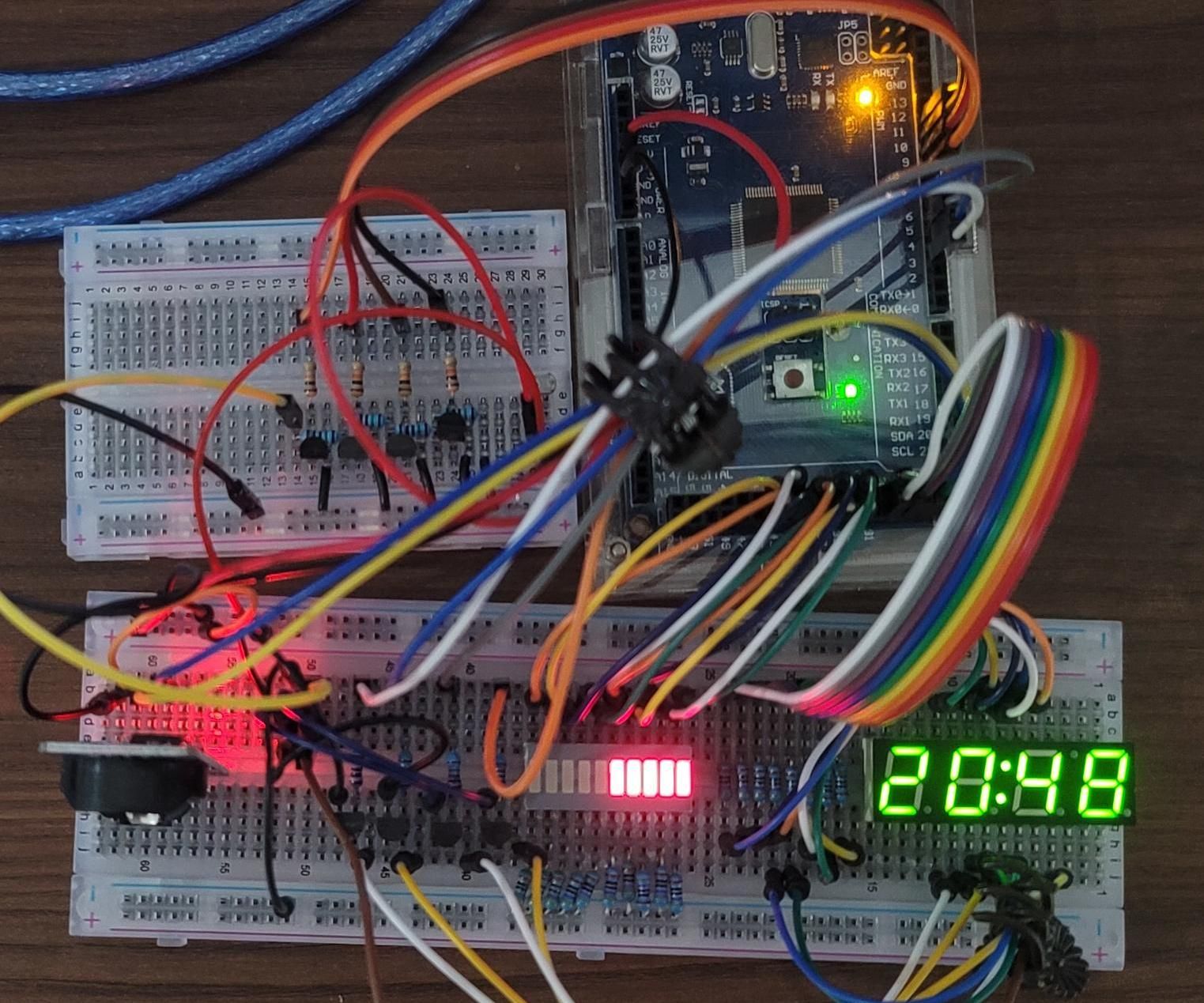

Thanks for the feedback.
I've also just posted another project which describes how to get Arduino to seemingly do multiple things at once.
This project builds up from a simply blinking one LED with a push button that "controls it", to a Mega Blinky LED Extravaganza.
It is all about the coding (but also makes a nice blinky light thingy). Check it out at https://www.instructables.com/id/Cooperative-Multi... or even just watch the blinky light video. :-)
