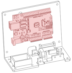

Step 2: Install Arduino
Screw the Arduino UNO into place using 4 6x3 screws. More details in the video here

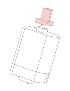

Step 3: Motor Installation
Using a small hammer tap the drive boss onto the shaft of the motor. More details on the video here

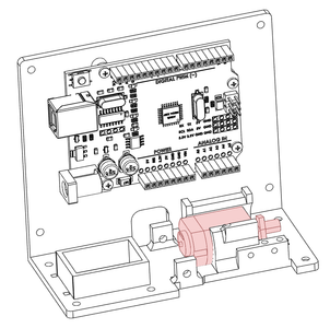

Step 4: Slide the Motor Into the Base of the Chassis.
Slide the motor into the base of the chassis.

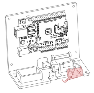

Step 5: Install Microswitch
The microswitch is installed into the front of the chassis with the two 2x16mm screws. One screw is fully tightened while the other is tightened just enough to hold the motor in place. More details are in the video here.

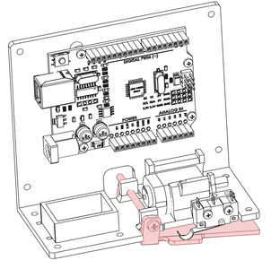

Step 6: Install Limit Paddle
The limit paddle stops the spider from driving too far up. The paddle is held in place by one 3x50 screw which runs across the chassis. The paddle should be able to move freely and without obstruction. When the paddle moves it should activate the microswitch. You should hear an audible click when the paddle is moved upwards.

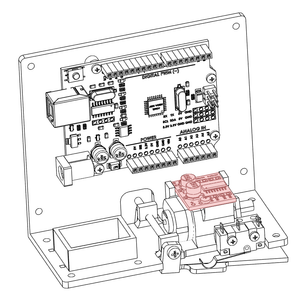

Prepare the motor driver for installation. The motor driver can drive two motors but we only need to use one for this project. Add a length of wire to each of the MOTOR A outputs. These will eventually be connected to our motor. Add a length of wire to the + and - terminals of the board. Then a length of wire to IN1 and IN2. Put a header pin on all but the motor wires to make installation easier later on.
Step 8: Install the Motor Driver Board
The motor driver board sits on top of the motor. There is a location for one screw and the rear of the board sits between two uprights. More details can be found here in the video.

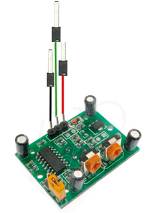

Step 9: Wire the PIR Sensor
The PIR sensor has 3 connections Ground, 5V, and the signal wire. Attach a length of wire to each contact as shown below.
