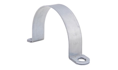

Step 6: Fixing the Module to the Bike
Fix the lights with the help of the C-Type Pipe Clamp. I added a layer of foam to avoid scratching the frame. The same was repeated for the other module as well.
You may use a D-Type Silicon Retaining Clamp or even an A -Type Silicon Retaining Clamp if you can get one.
