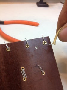

Following the diagram, the first part I needed to install was a capacitor. These are polarized and can be tricky. This particular cap had the end crimped and a + side marked at one end. Using the diagram, I determined the correct position.
I first straighten the legs of the component.
Then I line it up where it belongs on the board.
Next, I make 90 degree bends to allow the legs to fit into the eyelets of the board.
Finally, I bend the legs over on the underside to keep the part in place.
For this build, there are really not that many components, but for more modern guitar amps with higher part counts, you can have hundreds of components! It can be tough to keep organized.

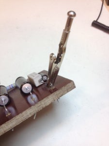

Step 4: Solder Al of the Leads
There are other tutorials about proper soldering so I will not dive into that now. Just follow procedure and be sure that you have good solid solder joints. Keep in mind that poor joints can cause capacitance. This can severely affect the quality of the sound! Take the time to do this properly. I used a heat sink (alligator clip) to keep from overheating the components. This is not always necessary, but is good practice.
I made sure to leave extra length on the wires that are being attached to the ends of the legs so that I can trim them back later. It's much better to have more length than you need than less. That way, it's just a quick snip...
