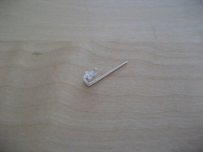

First use your Tir-wing screw driver to unscrew the nunchuck. Force off the top as it has 2 clips that it connects to.
Second, bend your LED to look like picture one (the long leg of the LED is the positive ( + ) on and the short is the negative ( - ) . If you want to save battery power, cut some of a leg off and add a resistor to it. Place a piece of electrical tape on the nunchuck PCB board to avoid shorts.
Then you are going to solder the legs of the LED to the test points on the nunchuck that I have pointed out for you (if you have trouble with the small test points i have listed alternates). Plug the nunchuck into your wiimote to test it out.
If you get your light to well... light up, you've done it right. Put the guts of your nuchuck back into its body and screw it back in. And thats it!!!!
