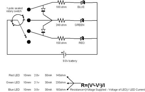

This particular version is switchable between 1, 2 or 3 lights. The parts list, as I made it, is as follows:
1 x Red 10mm clear LED ($0.90 AUD)
1 x Green 10mm clear LED ($2.70 AUD)
1 x Blue 10mm clear LED ($2.60 AUD)
1 x 180 ohm resistor ($0.38 AUD 8pack)
1 x 240 ohm resistor ($0.38 AUD 8pack)
1 x 150 ohm resistor ($0.38 AUD 8pack)
2 x diodes ($0.38 AUD 4pack)
1 x 9v battery ($5.65 AUD)
1 x 9v battery snap ($0.29 AUD)
1 x single pole sealed rotary switch (set to 4 position) ($2.95)
1 x Clear glass jar (I used an old coffee jar)
1 x Empty aluminium can
Broken glass (How much is needed will depend on the size of he jar)
0.12mm wire (To connect everything. USE A LIGHT INSULATION COLOUR)
Circuit diagram below is what I drew up after a brief discussion with the guys at work. (Thanks also to the guys at Jaycar for giving me a crash course in resistors)

Assemble the components as per the wiring diagram below. Bear in mind that the LEDs will be inserted at different levels. So varying lengths of wire may be needed.
Initially I made all the lengths the same, which was the total height of the jar. so any every LED is the same distance away from the switch when held up. This allows for any LED to be at any level but causes some minor problems with the slack being pushed up into the lid.

Can someone explain to me how the calculations for the LED resistors to work?
I'm using...:
Red: 3.1v-3.8v, current is 20-30 mA
Blue: 3.1v-3.8v, current is 20-30 mA
Green: 2.8v-3.2v, current is 20-30 mA

brooklyn:  Okedoke... The math for calculating the resistors needed for a given LED and power source is as follows.
Resistance = (Voltage Supplied - LED Voltage) / LED Current
If you use a search engine and do a look up, I think there are some people that have actually written web pages that where you can just plug in the info and it spits out the resistor needed.
Also if you take a look at the circuit diagram, I put the formula on there.

That should be.....
R = 5.5v / 25mA
R = 6v / 25 mA
Correct? but compared to the water flow theory this would be making the tube smaller for more resistance but with the same flow rate.....
Or is it okay?
Thanks

The circuit you have there looks ok. As you said you need 3 individual switches and that would have control over each light.. Should be nice. A couple of suggestions on the switch types you could use<br/><br/>1 <a rel="nofollow" href="http://www.jaycar.com.au/productView.asp?ID=SS0821&CATID=28&keywords=&SPECIAL=&form=CAT&ProdCodeOnly=&Keyword1=&Keyword2=&pageNumber=&priceMin=&priceMax=&SUBCATID=575">Miniature slide switch</a><br/>2 <a rel="nofollow" href="http://www.jaycar.com.au/productView.asp?ID=SP0736&CATID=28&keywords=&SPECIAL=&form=CAT&ProdCodeOnly=&Keyword1=&Keyword2=&pageNumber=&priceMin=&priceMax=&SUBCATID=652">Bedlamp switch</a><br/>3 <a rel="nofollow" href="http://www.jaycar.com.au/productView.asp?ID=ST0335&CATID=28&keywords=&SPECIAL=&form=CAT&ProdCodeOnly=&Keyword1=&Keyword2=&pageNumber=&priceMin=&priceMax=&SUBCATID=448">Miniature toggle switch</a><br/><br/>Would depend on the amount of room you have to mount the switches.<br/><br/>With the resistors, the formula is as follows<br/><br/>resistance=((Voltage Supplied - Voltage of LED)/LED Current)*1000<br/><br/>So when you go to buy your LEDs take a calculator with you so you can work them out and get the correct resistors at the same time.<br/>
