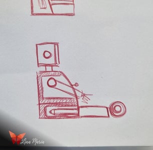

Step 1: Sketching the Idea
The idea of creating this multifunctional 3D-printed robot was born while I was eating sushi in a restaurant. I grabbed a pencil from my bag and turned the placemat into my sketchpad.
Later at home, I printed an image of the Instructables Robot and measured it roughly with a ruler to get a sense of proportions. Although I ended up changing many of those measurements during the 3D modeling process, those first approximations gave me a starting point to work from.

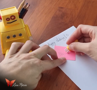

Step 3: Modeling the Drawer
I duplicated the body file and modified the hollow extrusion so that only the intersection between the torso and the extrusion remained—this became the drawer piece.
I hollowed it, added three cylinders for the buttons, and created an inner divider to store post-its. I also modeled the buttons themselves.
(When 3D-printing this drawer, I scaled it to 98% so it could slide in and out smoothly.)

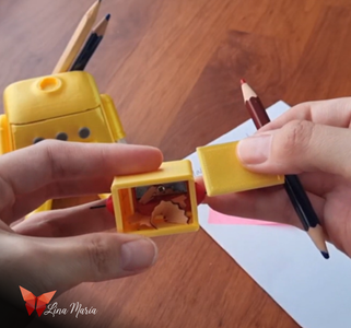

Step 4: Building the Head
I began with a rectangle extruded to fit the pencil sharpener. I added two small tabs to hold the sharpener in place, then extruded a larger rectangle to form the head. I cut a side hole for the pencil entry, created two guides on top for a sliding lid, and modeled a small neck with the bayonet mount attachment for the body.

Step 12: Installing the Sharpener
I pressed the sharpener into the head and added the sliding lid.

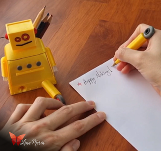

Step 13: Adding the Pens
I cut BIC pen refills and secured them by placing a small strip of masking tape inside the 3D-printed leg to tighten the fit. Then I inserted the refill, which stayed firmly in place.

For one arm, I inserted small eraser bars into the finger slots. For the other, I dismantled a soft children’s toothbrush, trimmed bristle sections, and glued them into the finger slots to form the brush hand.

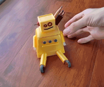

Now it was time to connect all the pieces and reveal the complete robot!
Step 18: Time to Use It!
And now the best part: putting the Desk Buddy Bot to work—sharpening pencils, erasing, cleaning, writing, and organizing, while inspiring your next Instructables ideas.
