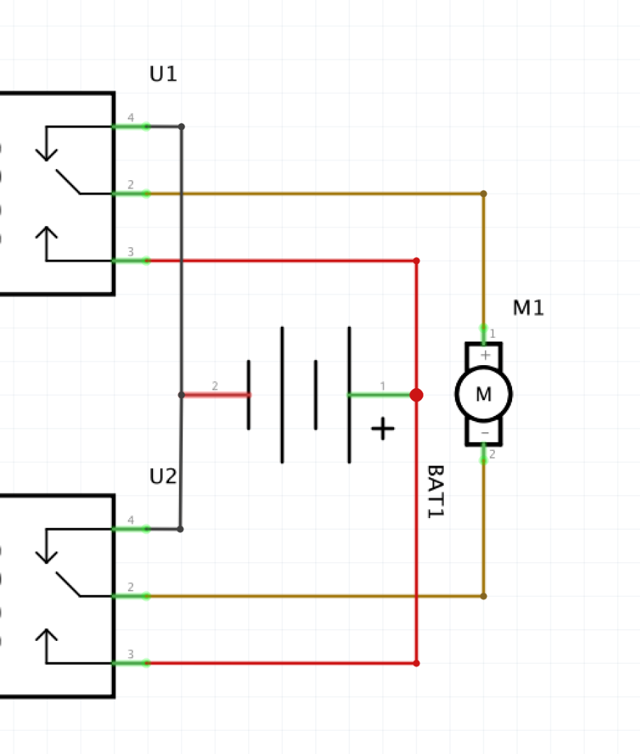

Step 2: Connect the Relay Module + Motor
Wire connection for the Relay switches & motor
motor + or - -> relay1 comm pin
motor - or + -> relay2 comm pin
external power supply (9v) + -> Relay1 NO & Relay2 NO
external power supply (9v) - -> Relay1 NC & Relay2 NC
Relay module VCC -> arduino 5v
Relay module GND -> arduino GND
Relay module IN1 -> arduino pin# 7
Relay module IN2 -> arduino pin#13
This was covered in the previous Instructable where we connected the 9v battery to the DC motor. In this project, we will be using the left and right sensors to control the direction of the motor.
Unlike the previous Instructable, IN 1 is connected to digital pin#7 while IN 2 is still connected to digital pin#13
