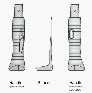

Step 2: Model Handle
For this knife, I have divided the handle into 3 parts, the part holding the pencil against the blade a part that just funnels the wood chips out and a spacer in between the 2 main handle parts. The pencil is held 15° off the blade to get a final angle for the pencil of 30° total. If you design your own model, you can then choose any angle.

My knife handle is split into 3 parts for ease of printing and a get a "nice" print quality out of my low budget 3D printer by minimizing supports but you can merge the 3 parts and print everything in one go. The metal parts are taken directly from the same donor knife that provided the blade.
