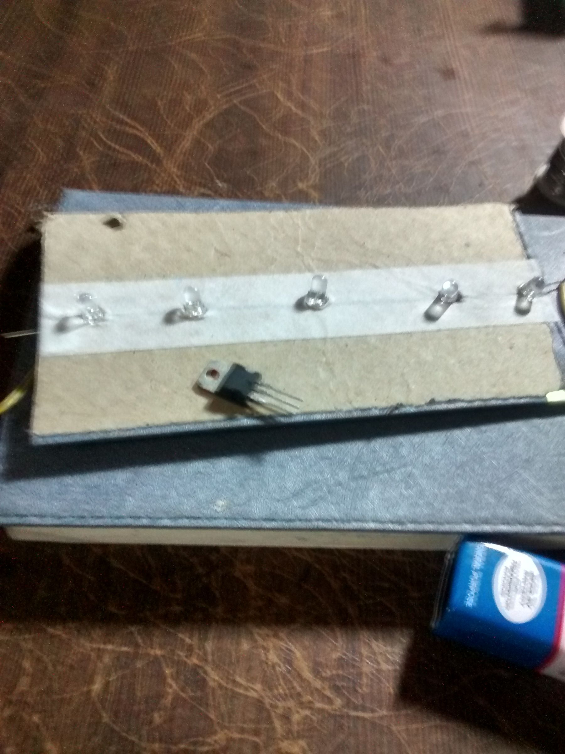

So I made this Music LED Light Box, but with some changes. Unfortunately it does not work for me yet.
I have used a TIP112 instead of a TIP31.
Three LEDs, with a nine-volt battery.
Could someone tell me why this does not work right? I thought I could change the 31 to an 112 because I had one laying around.
I have also use a 3.5mm Audio jack spliter.
0
ElectricGeckos
ElectricGeckos
Reply 4 years ago
Okay I resoder some of the wires and it work! You can use a TIP112 Transistor!

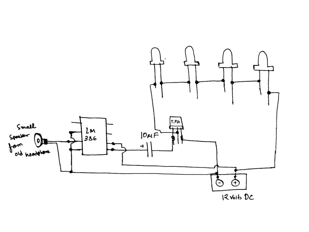

5 years ago
Hello there,
Its an awesome project. But i would like to add something to the circuit if you guys dont mind. :)
The thing is for this circuit you have to give an input to it via 3.5mm jack.
But using my mod you can use this circuit to make a portable beat sensing light box. Place it on a table when music is being played and the box will response to beats on its own without connecting any cables.
Hope it helps.
Regards :)

Hi, just wondering what orientation the LM386 LowAudioAmp and TIP31c Transistor are in? Thanks.

Hi AnikB, what is the 10 mu F item, is it a 10 ohm resistor because I can see someone has referenced a 120 ohm resistor. What do I need please?

Hi AnikB, interesting adding. Do you think it could work using a piezo element, say a piezo disc, instead of the speaker?
0
AnikB
AnikB
Reply 5 years ago
A piezo would work definitely. But to my thinking , it would pick up more of the treble of the song rather than the bass pump you would be looking for.
I think , If you attach the piezo with a both side tape on a wooden frame , it would work better :)
