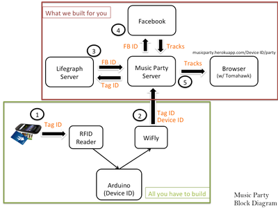

System Overview
Check out the block diagram image for a pictorial representation of the system or follow along with the video above.
It starts with the RFID reader reading the unique id of whatever device/card was placed near it (we'll call this the Tap ID). The reader passes the Tag ID on to the Arduino which sends it and the Device ID (which you will make up) out to our Music Server through the WiFly module. That's as much as you need to build! The rest has been extracted into a separate server that can handle everyone's requests to remove a lot of the complexity. If you want to configure your own server you can check out the Github repository for it or let us know and we'll make a tutorial for it!
The server will take care of converting the Tag into a Facebook ID, grabbing the musical preferences of that person associated with that Facebook ID, merging those tracks back into the playlist for everyone else in the room and passing those tracks to who ever connects to the URL associated with the Device ID (musicparty.herokuapp.com/*Device ID*/party). We are using the Tomahawk API when you connect to a music party in your browser to find a media source that can stream each particular track (youtube, soundcloud, etc.).
We built the Lifegraph Connect platform to have a centralized API and database for bridging physical and digital identities. It's easy to use, and once we put the hardware we'll sync our IDs there so that we can convert an RFID tag to a Facebook ID.

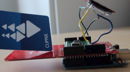

Step 1: Set Up the Hardware Stack
The first thing we'll need to do is put out hardware together. If you haven't soldered the stackable header pins onto your RFID shield, you should do that first. Lady Adafruit has a great video that explains how to do it for first-timers.
After you're done soldering the stackable header pins to the shields, you'll need to attach the WiFly module. We've made a whole tutorial dedicated to connecting the Arduino to the internet with WiFly but for the sake of this Instructable, just follow the section for soldering and connecting the pins into the shield. You can see a picture of the hardware stack below (with the Sparkfun board).

Place the RFID Shield on top of the Arduino. Now we can get to the code. All the code you'll need can be found here in our Github repo.
Create a new Arduino sketch by selecting the Arduino application and clicking the dog-eared paper icon, copy the code from the link above right in, and save it in your project directory. All you have to do now is uncomment three lines at the top of the file depending on which RDID reader you have.
If you have the Sparkfun sm130 RFID board, uncomment these three blocks:
And if you have the Lady Adafruit RFID board, uncomment these three blocks:
The rest of the sketch is the same for both boards because we wrote the sm130 library to match that of the Lady Adafruit library. Now, click the right-facing arrow on the sketch to load the code on the Arduino and start running it. To see the output, open the serial monitor by going to File->Tools->Serial Monitor then make sure your baud rate is set to 9600 (the dropdown on the lower right of the serial monitor).
Now, if you tap your RFID card on the reader, it should print out the Unique ID! Awesome.

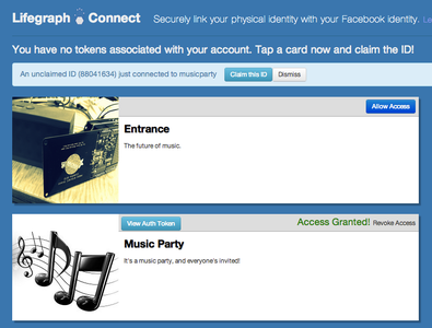

Step 4: Syncing Identities
Lifegraph Connect is a platform we build to sync digital and physical tokens. Anyone can develop an application on top of it. Email us at lifegraphlabs@gmail.com to learn more about it!
Open a browser and go to lifegraphconnect.com/musicparty and enter your Facebook credentials. On the next screen then click "Grant Access" on the Music Party app after you're redirected back to the Lifegraph Connect website. Now tap your card again and notice that an alert box pops up and says that a new, unclaimed ID was detected (see image). Click the button to claim it and you're all set!

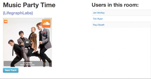

Now that you're synced. You can tap in to start streaming and tap again to stop streaming (it would be a good idea to add some LEDs so you have a better indicator of what's going on).
Open http://musicparty.herokuapp.com/YOUR_DEVICE_ID/party where YOUR_DEVICE_ID is the deviceId you entered in your Arduino sketch. Tap your NFC/RFID device on the RFID reader and watch as you join the room and your favorite music starts playing! Now you can easily sync all your friends card and you can all automatically have your favorite music play without having to manage playlists!
Note: If you don't see any music play when you're added to a room, go like more music on Facebook. Then tap out and back in again.
