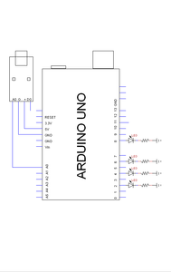

Ever seen a stereo or a sound system with bars that reflect the beat of the music. This circuit does much the same thing.This is done through a loop that observes changes in loudness and lights a number of LED's that corresponds to that change.
In the video you will see how the code works and see it respond to voice and music.
Components Used:
•Arduino Uno
•400pts Breadboard
•Jumper Wire
•Microphone Module
•4 x LED (5mm)
•4 x Resistor 300Ω
