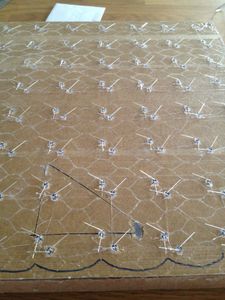

This is making a very large version of the common cathode matrix found in the attached datasheet.
Firstly, cut some wires, and strip them, lots of them - I suggest you buy a wire stripper, I did and it made it so much easier! Once you think you've got enough, cut some more! You'll need 56 black wires and 112 red wires. Each should be about 7 to 8 cm long, but this will vary depending on your array, so just check before you cut all of them. As you'll see in one of the first pictures, I placed a marked piece of paper on my table, laid the wire along it and cut it into strips. This made the pieces the same length.
Next, to save my fat fingers whilst soldering, I twisted the wires into lengths of 7 pieces of wire - this was so I could solder the wires without trying to hold multiple wires at once.
*** to make the next bit slightly clearer, I've added some diagrams that should highlight which wires are connecting where***
Having made the board with the holes,
Insert the LEDs in the back-side of the board and bend the legs over so the cathodes touch, but the anodes are separate.
Solder all the cathodes together using the black wires.
Solder all the anodes together using the red wires.
