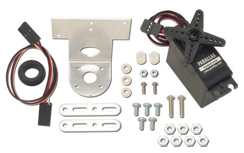

1 - Ping))) Parallax  mounting bracket kit http://www.parallax.com/Store/Robots/AllRobots/tabid/755/ProductID/248/List/0/Default.aspx?SortField=ProductName,ProductName

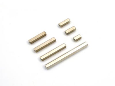

4 - PCB spacers from 4 cm http://http://www.robot-italy.com/product_info.php?cPath=7_135&products_id=1189

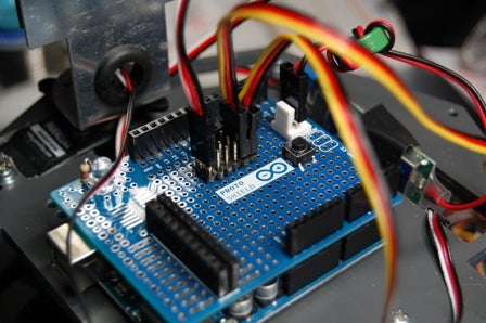

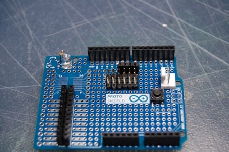

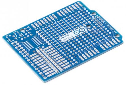

Step 2: SERVO SHIELD CONSTRUCTION
First we begin by shield, why I have chosen this path?. When you need to connect several servo motors, a sensor, batteries etc, of course, there are several PIN signals, power supply and ground to use.
Normally the various little robots are joined by a breadboard to allow you to manage everything at the expense of a lot of threads around that maybe every time you disconnect and still always give a feeling of chaos.
A shield to be attached  to Arduino simplifies everything and makes it more convenient connections. As you know for the servos or motors there are already on the market different and functional, eg one or dell'Adafruit or SparkFun, in any case the realization in the house is very simple and inexpensive.
As you can see from the first two photos are soldered several rows of three legs (I have made ​​6, but you can add several more), each leg corresponds to the three poles of the servo and the sensor (signal, 5v, gnd -white/red/black or yellow/red/back). Then sold in parallel (third photo) the 5v (center pin) and GND (pictured blue wire) and the latter connected to the power connector, so all you will connect to the row of pins will be powered together.
For the signal pin, you can decide if you knew at the start (as in my case) corresponds to which pin, solder a wire directly to the corresponding pin, or if you want to manage it from time to time just add (second photo), a row of strip females to connect with a wire to the desired pin. In the above I added a reset button and a LED connected to pin 13 directly to Arduino board.

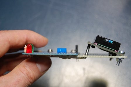

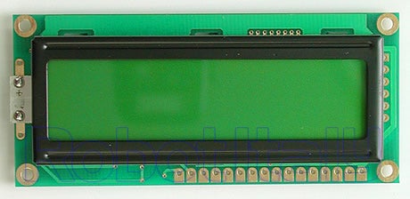

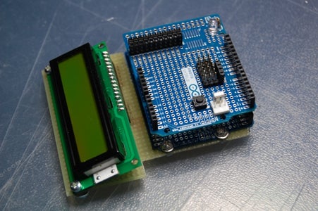

Step 3: LCD SHIELD CONSTRUCTION
Skipping of course, as you will find dozens of tutorials on how to connect one display to Arduino board eg
http://arduino.cc/en/Tutorial/LiquidCrystal
but I repeat, if you want to take the opportunity to enter into the project, which necessary to reduce the number of wires around that in this case are several, so we can again make a shield that can be useful for other projects with the Arduino.

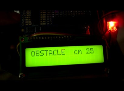

Of the 16 pins of a display, only 12 are needed for our purpose.
If you look at the first and third photo should crop a breadboard that will serve us well as a support for the display, and like a  "bridge" connecting to the Arduino pins.
So what should we do, sold (I have soldered slightly inclined, as shown in picture 2, in order to better read the display) a female strip of 16 feet to the matrix board, make from each pin that is used (see the tables below) a wire soldered directly to the corresponding pin of Protoshield, then we're going to overlap to the Arduino board and above this shield (last photo) will get that one made for the servo and sensor with zero visible wires.
The last photo is the display in operation.

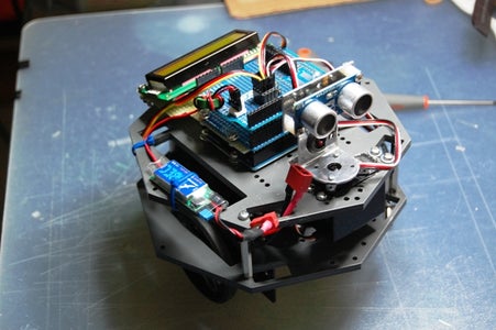

Step 5: ASSEMBLING THE ROBOT- FIRST FRAME

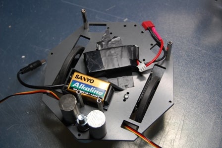

At first frame I have inserted two servos rotated 360, a support for the 9v battery, and I attacked, I know ... look like shit, a lipo battery.
I chose this system because, who uses lipo for model knows, I like to take the residual voltage monitored to prevent damage to the battery, with tape so I can remove it easily.
Why two power supplies? Here you can breed different opinions, in any case I think it is better to keep the logic separated (Arduino) to avoid interference from the motors.
Where you see the bolt I put a wheel pivoting and two weights because the front was slightly unbalanced.
The third photo is the bottom.
Step 6: ASSEMBLING THE ROBOT- SECOND FRAME

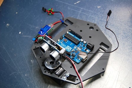

Now prepare the upper frame.
I made ​​a space for the Ping servo, four holes to secure the Arduino and I placed the strap securing it with a UBEC that you see on the left and right of the two photos.
For those not familiar in practice, is used to regulate the output voltage of the battery, because the lipo 2s has a voltage of 7.4 v, while the servo has a conduction voltage range from 4.8 v to 6.
Can also be used diodes or other.
Insert spacers and overlap the first frame to the second.

lcd.clear();
lcd.setCursor(0,0);
lcd.print("OBSTACLE  cm ");
lcd.print(timecount/10);
