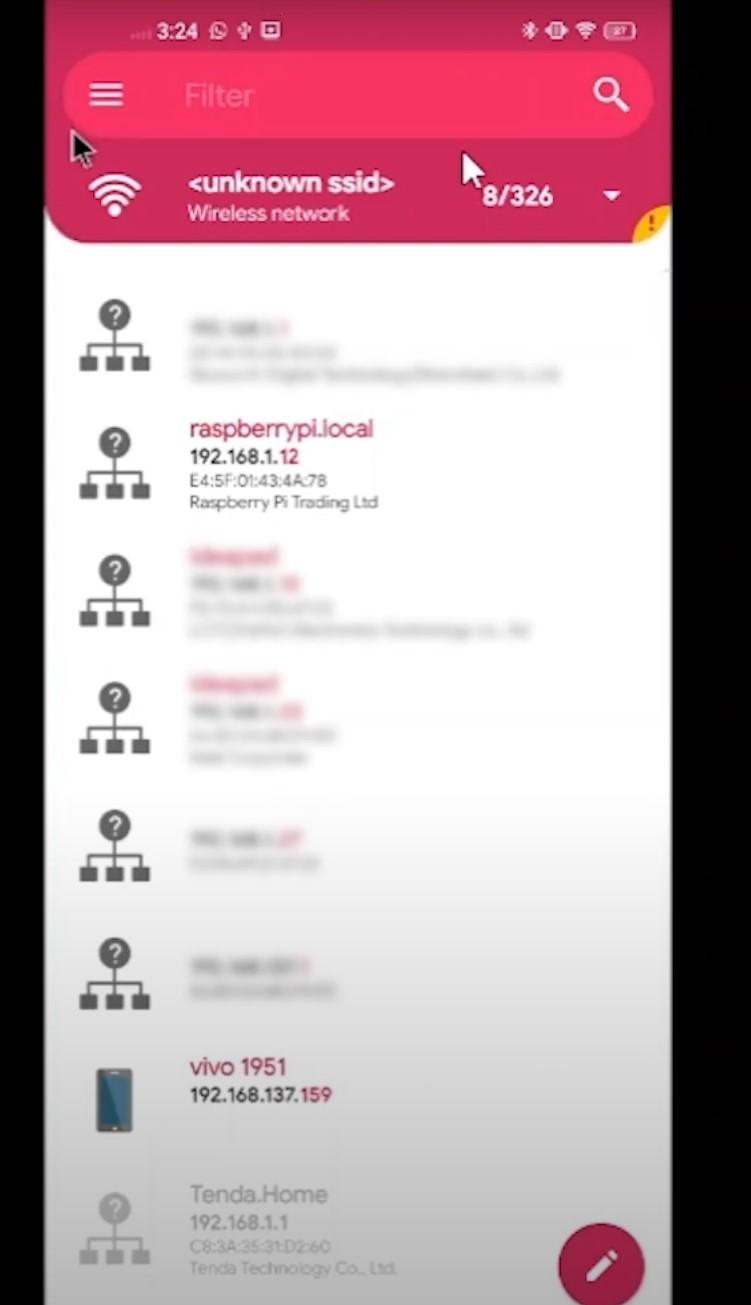

Install the app called netX to view the IP addresses of the devices connected to your IP-address

  • Enter the following command to ssh into the Raspi with the IP address of the raspi you get from the netX app
