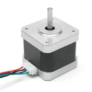

  • Stepper motor NEMA 17

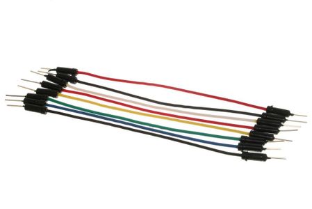

  • Jumper wires

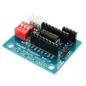

If using a Stepper Motor Driver Shield:
  • Connect Motor Shield GND pin to Arduino negative pin [GND]
  • Connect Motor Shield [5V] pin to Arduino positive pin [5V]
  • Connect Motor Shield GND pin to Power Supply negative pin [GND]
  • Connect Motor Shield [9V] pin to Power Supply positive pin [+]
  • Connect Motor Shield pin[S] to Arduino digital pin [2]
  • Connect Motor Shield pin[D] to Arduino digital pin [3]
  • Connect stepper motor as shown on the picture.

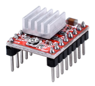

If using a Stepper Motor Driver 8825:
  • Connect DRV8825 GND pin to Arduino negative pin [GND]
  • Connect DRV8825 DIR pin to Arduino digital pin [3]
  • Connect DRV8825 STEP pin to Arduino digital pin [2]
  • Connect Power Supply for the motor to DRV8825 VMOT and GND
  • Connect Capacitor across VMOT and GND

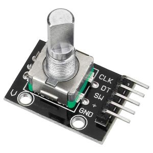

Connecting Encoder module:
  • Connect Encoder module pin [CLK] to Arduino digital pin [5]
  • Connect Encoder module pin [DT] to Arduino digital pin [6]
  • Connect Encoder module pin [SW] to Arduino digital pin [7]

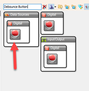

Step 4: Start Visuino, and Select the Arduino UNO Board Type
Start Visuino as shown in the first picture Click on the "Tools" button on the Arduino component (Picture 1) in Visuino When the dialog appears, select "Arduino UNO" as shown on Picture 2

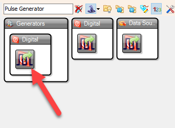

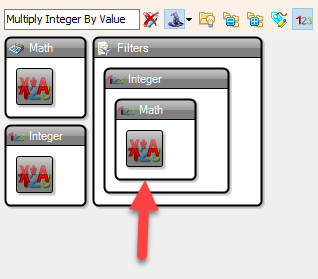

Step 5: In Visuino Add Components
  • Add "Multiply Integer By Value" component

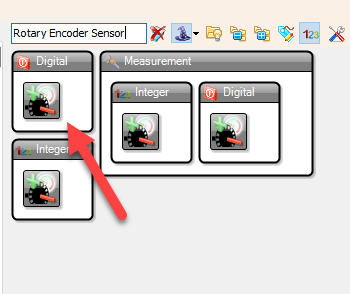

  • Add "Rotary Encoder Sensor" component
  • Add "Pulse Generator" component
  • Add "Toggle(T) Flip-Flop" component
  • Add "Debounce Button" component
Step 6: In Visuino Set Components
  • Select "MultiplyByValue1" and in the Properties window set "Value" to 50

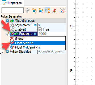

  • Select "PulseGenerator1" and in the properties window set "Frequency" to 2000 << this will be the default starting speed of the stepper motor, you can adjust it to your needs
  • select "Frequency" and click on the Pin icon and select "Float SinkPin"

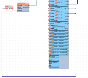

  • Connect Arduino digital pin [6] to "RotaryEncoderSensor1" pin [Direction]
  • Connect Arduino digital pin [5] to "RotaryEncoderSensor1" pin [Clock]
  • Connect "RotaryEncoderSensor1" pin [Out] to "MultiplyByValue1" pin [In]
  • Connect "MultiplyByValue1" pin [Out] to "PulseGenerator1" pin [In]
  • Connect "PulseGenerator1" pin [Out] to "TFlipFlop1" pin [Clock]
  • Connect "TFlipFlop1" pin [Out] to Arduino digital pin [2]
  • Connect "Button1" pin [Out] to "TFlipFlop2" pin [Clock]
  • Connect "TFlipFlop2" pin [Out] to Arduino digital pin [3]

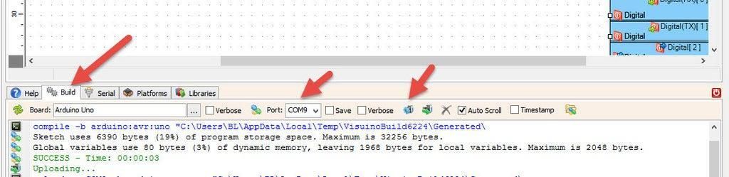

Step 8: Generate, Compile, and Upload the Arduino Code
In Visuino, at the bottom click on the "Build" Tab, make sure the correct port is selected, then click on the "Compile/Build and Upload" button.
