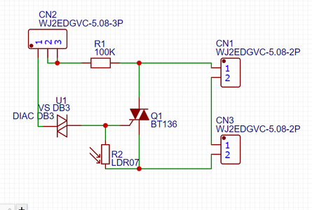

Step 1: SCHEMATIC DIAGRAM
Here we will see the schematic diagram used in our circuit

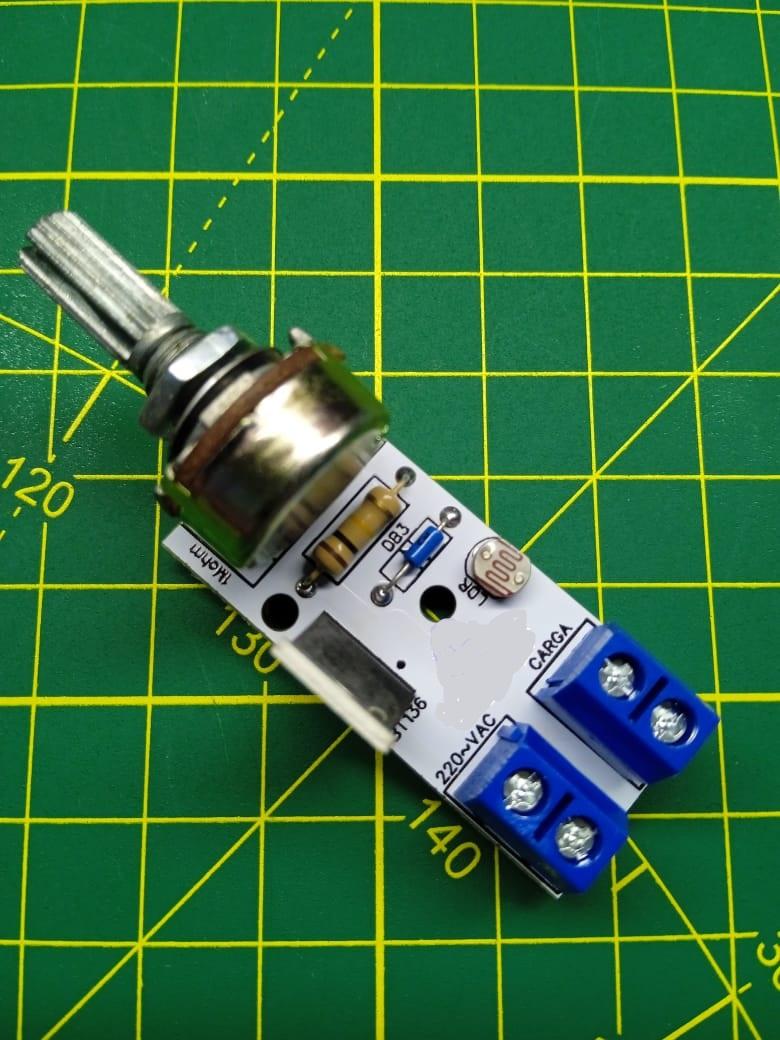

Step 2: FUNCTIONING
The operation is basic when there is light or illumination the LDR will have a very high resistance so it will not activate the GATE of the TRIAC, but when it detects darkness its resistance will decrease almost to 0 OHMS and this will let the current pass to the GATE and activate the TRIAC letting the CURRENT pass from T1 to T2.

Step 5: ELECTRONIC COMPONENTS
·        1 TRIAC BT136
·        1 DIAC DB3
·        1 RESISTOR 1/2W 100K
·        1 LDR
·        1 BLUE TERMINAL BLOCK 3 PINS
·        2 BLOCK TERMINAL BLUE 2 PINS
·        1 POTENTIOMETER 1Mohm
·        1PCB
Step 6: FEATURES
·        MAX OUTPUT CURRENT 4A
·        VOLTAGE CONTROL 220VAC
·        CHANGEABLE SENSITIVITY
·        COMPACT CIRCUIT
·        FULLY VOLTAGE CONTROLLED CIRCUIT 220VAC 60HZ
·        WORKS FOR BOTH 110VAC /220VAC 50HZ/60HZ

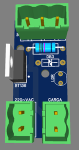

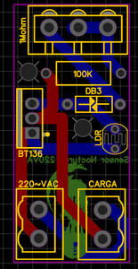

Step 7: EASYEDA
HERE WE WILL SEE THE IMAGES OF THE 3D IMAGE AND THE TRACKS OF OUR PCB DESIGN.
