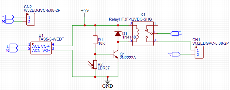

Step 2: SCHEMATIC DIAGRAM AND OPERATION
Here we will see the operation by means of a voltage divider between the resistor R1 and the LDR through these two resistors we will detect a positive current and a negative current.
When there is darkness, a positive current will reach the base of the transistor, activating the RELAY and the 220VAC bulb.
When there is light, a negative current will reach the base of the transistor, deactivating the RELAY and therefore the relay and the 220VAC bulb do not work.

·        SOURCE AC/DC MODULE POWER 220VAC/5VDC 1st
·        1 BJT TRANSISTOR 2N2222A
·        1 RESISTOR 10K 1/2W
·        1 LDR
·        1 DIODE 1N4148
·        1 RELAY 5VDC
·        2 TERMINAL BOARDS 10A
·        1PCB

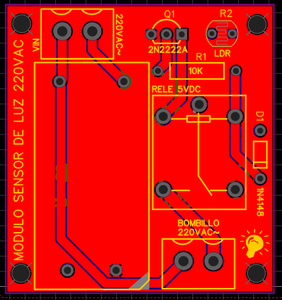

Step 5: PCB Design in EASYEDA
Here we will see the pcb design in the easyeda software and the 3D image of the PCB.
