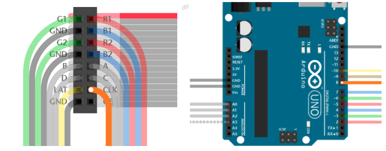

Circuit diagram above is from Adafruit RGB LED Matrix Basics.
Initially, I had planned to use an ESP32 to run my RGB matrix display and make my API call. However, because of the power requirements of the display, I switched to an Arduino UNO and a breadboard to provide the extra grounding required.
I used the Adafru.it RGB Matrix tutorial to get my display set up and working. I followed the pinout guides and wiring in the Connecting with Jumper Wires tutorial for the RGB matrix in order to create my circuit, making sure to adjust as specified in the tutorial for the UNO. Then I ran the test code examples to make sure my circuit was working and to get familiar with how to program the display.

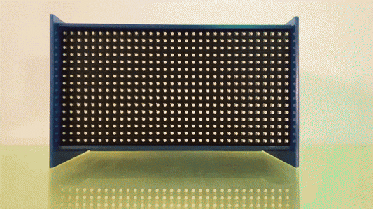

  1. Thinking ahead to the information I wanted my ferry clock to display, I hardcoded in an example message so that I could make aesthetic adjustments to accommodate the desired text.
  2. I tried out some different fonts for the text using the GFX library mentioned above, ultimately landing on FreeSans 9pt 7b.
  3. Out of the box, text on the display zooms by very quickly, so incorporating a scroll delay was important for legibility. I introduced the delay as a variable upfront and then called it directly in my loop(), working from the code in this forum post.
  4. I adjusted the position of the cursor for optimal legibility of the text on the display.
  5. I changed the color of my text to blue, to go with the case that I designed for it.
This sketch allowed me to finish a "looks like" prototype, which served as a guide for me when it came to incorporating real data from the NYC ferry schedule.

Step 5: Make the Box
For this design, I went with a tab and slot box because I always find it beneficial to be able to revisit my circuits if I want to improve them in the future, and a tab and slot design avoids the need for glue.
I created a simple vector design for my box in Adobe Illustrator before I learned about MakerCase, which is a web tool that instantly creates box templates for laser cutters from a set of input dimensions. I recommend using MakerCase instead of DIYing it unless you're hoping to make something really custom :)
The file for the encasement I created is attached if you'd like to use it! I had initially planned to include 2 rotary switches in my design, to allow the user to rotate through routes and stops, so there are some holes in the top panel to accommodate those. There is an exit hole in the back panel for the power cord. Everything else (my UNO and all of my cables) fits snugly inside behind the display which serves as the front of the box.
I cut the pieces out of a pearlescent blue acrylic which gives off the feeling of waves. It might not be an accurate depiction of what the East River water looks like, but hey, it's aspirational ;)
