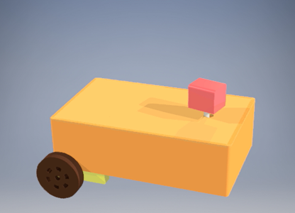

We want the RC car to have a tilting head that is glued to the servo. With this in mind, we will 3D print a head for the servo. Additionally, we will 3D print a stick that can serve as a connector between the head and the servo (I wrapped a bunch of duct tape to ensure that the servo and stick will stay together). Next, we will drill holes to the box that we will use as a foundation for the wheels. Tip, I used the chassis to know where to drill the holes. It is important to drill a hole at the very center so we can utilize it as an opening for the wires of the motors. Additionally, although not shown in the images, I drilled to small holes at the front and back of the box so I can glue the led lights to it. For circuit purposes, I sautered the led wires to jumper wires. The box should be set up as shown above.
