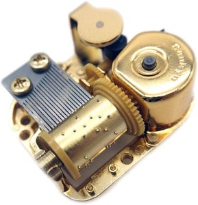

  4. Music box mechanism (18-note, "Little Town of Bethlehem")
  5. The Music Box Company

  1. A main box with built-in slot for the Sankyo or Pursuestar music mechanism

  3. Install Music Component:
  4. Slide music component into the slot, lining up the screw holes.
  5. From the bottom, use 3 screws to hold the music component tight.
