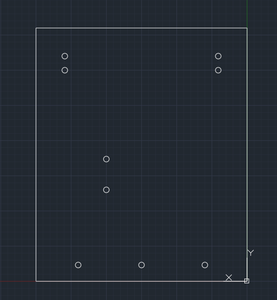

First, we use the laser cutter to cut four rectangle acrylic plates based on our CAD graphs to be the frame of the robot. And prepare a lot of screws and screw caps.
Step 6: Assembling Steps 4. Constructing the Base
(1) Take a 3 mm-thick acrylic board for a 150mm×180mm rectangle for the baseboard.
(2) Drill three 4mm round holes on the edge of the acrylic platform to connect with another board by using 3 turn angles.
(3) Drill two 3mm round holes on the base to fix the servo motor firmly on the board.
(4) Fix the Arduino board, motor board and batteries on the base by glue.
(5) Drill four 3mm round holes each side to fix two motors on the base.
(6) Using screws to connect the wheels with motor.
