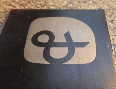

Since shaft encoders are a bit boring, I also etched a graphic by HiddenPower, gmjhowe's logo and the hackaday logo to see how solid images looked as well as to give me a more interesting title image. I think they turned out great!

Once fully dry the painted stainless can be etched. I used a high power (98/100) , a high etch speed (300/400) and a step size of 0.1mm per scan. These worked better than the original settings I used since the thinner sheets of metal warped when I ran it at a lower speed.
The shaft encoder was designed in a CAD program called Alibre then exported into the program that came with our laser cutter as a .dxf file. This one took 2 minutes to run.
The logos I etched were imported as jpegs and the program sorts out the rest. They took slightly longer to etch since there was a larger area of paint to remove, 4 or 5 minutes.

And here are some shots of the finished etched sheets.
