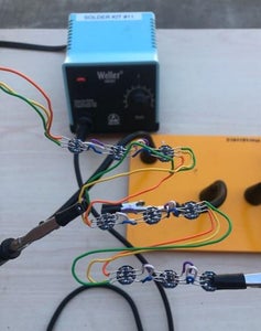

The attached files contains pricing and links for the materials. The list was created early in 2021 so the prices may change. The neo pixels listed were used when we made this project, we suggest using neo pixel strips to avoid having to solder each of the individual neo pixels together.

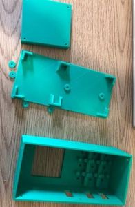

The stl files were designed by Jacob Fisker-Anderson. The spacers are designed to raise the Arduino Uno up off of the back plate. The stl files will work in most slicing software, allowing the file to be turned into G-Code that the 3D printer will use to complete the print. The figure is for referencing how the pieces all fit together.

Here are some of the pictures of the assembly process. Depending on wire management the housing can run out of room quickly. We recommend that everything is tested prior to assembly to avoid any errors from faulty equipment. Additionally, whenever a joint is soldered it should be checked for continuity to ensure that the solder was successful and the piece is still functional.

Use neo pixel strips instead of individual neo pixels to avoid a good deal of soldering. Check continuity for every connection as you solder.
