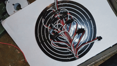

Step 1: De-soldering Original Leads From Rings
Now, this step is not necessary required, however it makes the plate of LEDs have a much smaller form factor, making the final project slimmer. if you feel confident in your soldering skills, follow theses next couple of steps:
carefully pass a tinned soldering iron over the ends of the leads and pads to melt the solder while gently pulling the end of the wires with your other hand.

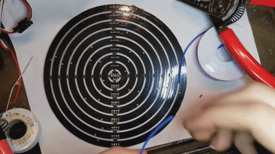

Step 2: Soldering GND and +5v on the Rings
carefully strip some wires and tin them and, in a strait line, from GND to GND, and 5v to 5v. Press the soldering iron to the pads and wire to solder them down, be careful as the exposed wire can get hot. add or remove solder as needed.
finally add the 470uf capacitor to the ends of the two power rails to protect from voltage spikes.

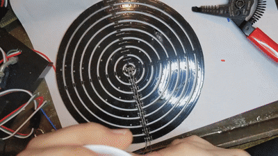

Step 3: Soldering the Signal Wires
now comes the hardest part of the re wiring. The signal wire needs to move from the DO to DI so the data overflow from one ring goes to the input of the other.
because of this we need to strip and tin small pieces of wire and snake it over the 5v and GND lines.
the easiest way I found was to:
  1. solder one side to the pad
  2. cut the wire to length
  3. strip and tin the other side of the wire
  4. using a pair of pliers hold down the other side and
  5. solder the other side

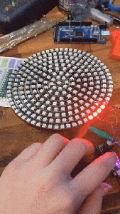

Step 11: Test the Rings
now we get to see our hard work in action. strip and tin the other ends of the 5v, GND, and DI of the outer ring. now we take out the trinket, and connect the DI to pin 1, GND to GND and 5v to USB. don't connect the 5v to any other source on the board unless you're going to make it battery powered as it will pull way too much current from the board.

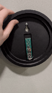

Step 16: Final Assembly
finally screw down the final board with the m2 screws (and heat inserts if you choose) and then test the plate of neopixels. if it works, glue the led plate in place (i know, not ideal, but there is no real mounting points on the LEDs) and finally glue the lithophane on top of it all. you should be able to plug in and hang it on the wall
Step 17: Hanging
mount the final product on a screw in a drywall anchor or into a stud, and hang the body using the cutout at the top of the body
