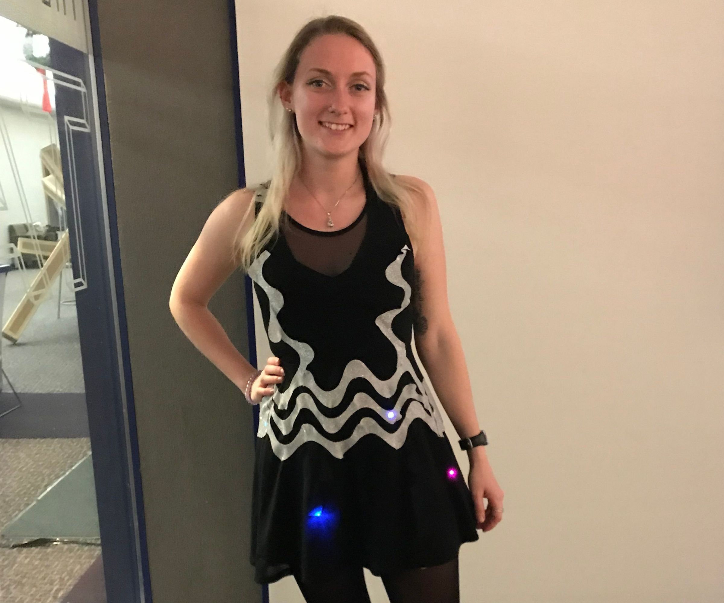

For my electronics art class, we are making wearables for the Pensacola Maker Faire. I was inspired to make this dress to be able to work with conductive thread and sewable neopixels. This is a decorative/fashion piece using an Arduino and Doppler Radar Motion Sensor to keep the dress blinking with lights. Laura Dempsey made a motion-sensitive dress for Make Fashion. Her craft to the dress is well executed and is part of my inspiration. I'm also excited by Dutch fashion designer Iris Van Herpen for her unique forms she creates using many materials on her pieces. These fashion icons are references to what I researched. I've decided to laser cut glittery fabric to attach to the dress to unify the neopixels in the round. The neopixels will be under a sheer lining the dress has. The housing of the Arduino will be a pouch and belt attached under the dress of the wearer. It will run off 9V battery and twinkle away with many colors.

The biggest thing I've learned during this project was finding a way to successfully connect soldering wires to sewing with conductive thread(pictured). I used this neopixel as a test with one connection and then used alligator clips for the other two connections. It was successful and I felt at ease to finally start sewing the neopixels onto the dress. This also allowed me to practice sewing with the conductive thread before starting the dress.
I also learned how to use a laser cutter and the many materials able to be used on this machine. Like cutting fabric (pictured) to get precise detailed drawings. I revised the outline and made the waves thicker. Since I will probably sew the fabric onto the dress it would be easier to manage if slightly bigger.
My final instructable with the dress completion will be done in a few weeks. Hopefully, all neopixels will work. I'm worried some may be loose because the fabric is a little stretchy and being my first time sewing with the conductive thread. I have just the power lines to sew and to check lines with multimeter. I checked the data line and it showed a read of a secure connection.
