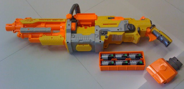

The problem with the Vulcan's battery box is that sometimes after you have replaced your batteries the gun will not auto-fire. Well, here's a straightforward fix that anybody can do.

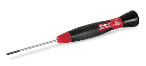

Step 1: Tools Needed
  • A very small Phillips head screw driver.
I used my Snap-on SSDEP200
Step 2: Remove the Battery Box From Your Vulcan
Its just like replacing the battery Pack.
If you don't know how turn the Vulcan over so you see the orange trigger.
3" from the tip of the trigger you will find the screw.
Loosen the screw until the cover can be removed. and slide of the battery box.
Step 3: Fix It.
  • Lay it down so the bottom (with the screws) is facing you.
  • There are fifteen (15) screws and remove them.
  • Remove the four (4) covers
  • Remove the four little dividers
  • You don't want the dividers, as they are the problem.
  • Re-Install the four (4) covers
  • Re-Install the screws.

Step 4: Put the Battery Box Back.
  • Put the batteries in the battery box.
  • Make sure that bottom of the battery box goes in correctly (lip goes up).
  • Re-Install the Battery Cover.
