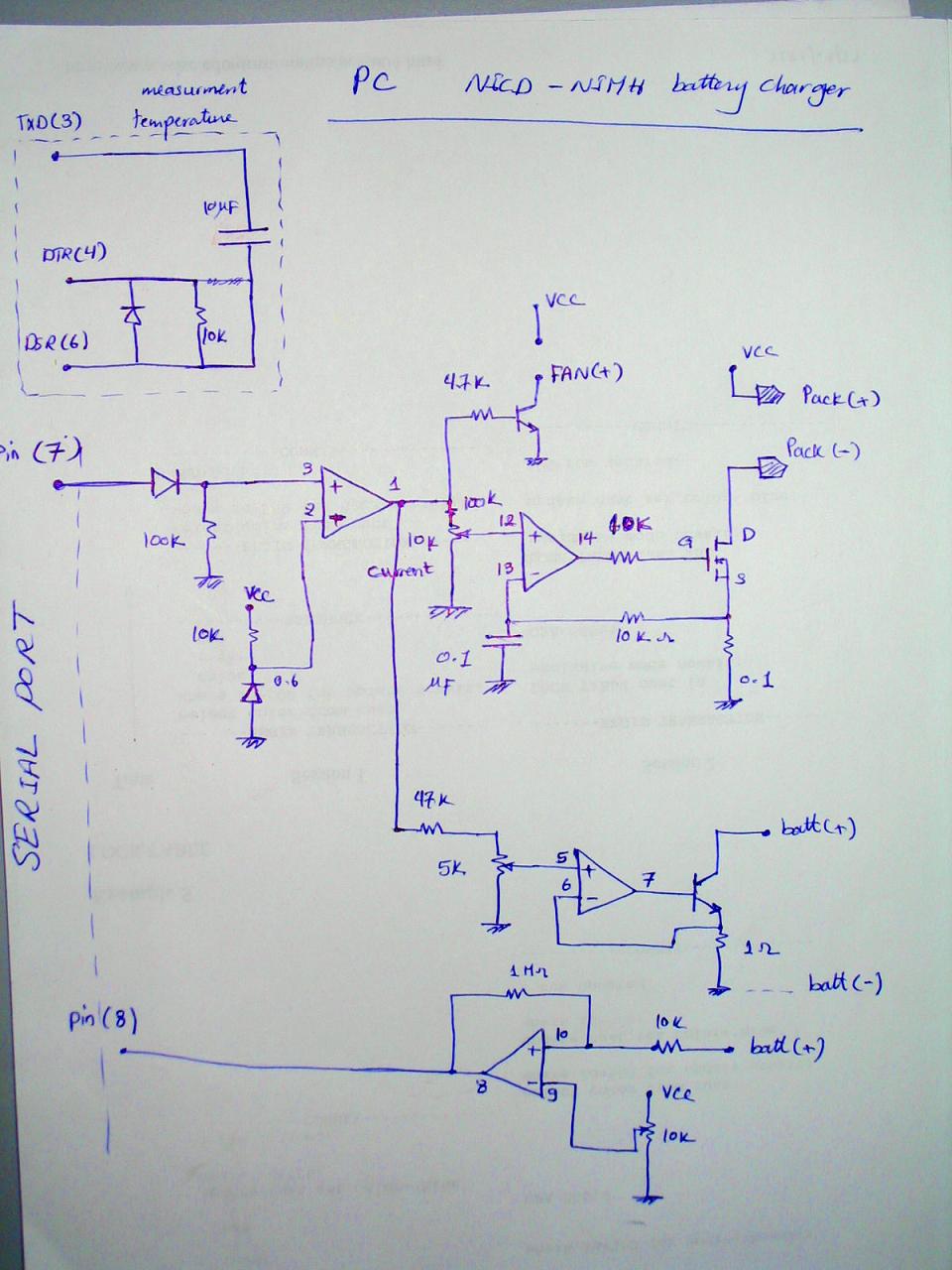

Step 1: The Schematic
The circuit can be divided into e main parts:
Measuring the temperature:
This is the most interesting part of the project, the purpose is to use a low cost design with a low cost components along with a good accuracy. i have used the great idea from
http://www.electronics-lab.com/projects/pc/013/ , review it , it contains all the required details.
A separate module in the program has been written to measure the temperature, as it can be used in other purposes.
The charging circuit:
- I used LM317 in the first design, but the efficiency was too bad and the charging current was limited to 1.5A, in this circuit i used a simple adjustable constant current source, using one comparator of the LM324 IC. and the high current MOSFET trannsistor IRF520.
- The current is adjusted manually using the 10Kohm variable resistor. ( i'm working on changing the current through the software ).
- The program controls the charging process by pulling Pin(7) high or low.
The discharging circuit:
- I have used the remaining two comparators from the IC, one for discharging the battery pack and the other for listening to the battery voltage and stop the discharging process as soon as it drops to a predetermined value ( for ex. 1V for each cell )
- The program monitors pin(8) , it will disconnect the battery and stop charging when it's logic level "0".
- You can use any power transistor can handle the discharge current.
- Another variable resistor ( 5K ohm ) controls the discharge current.

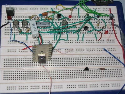

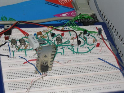

Step 2: The Circuit on the Bread Board
The project has been tested on my project board before making the PCB

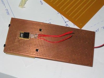

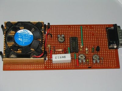

Step 3: Preparing the PCB

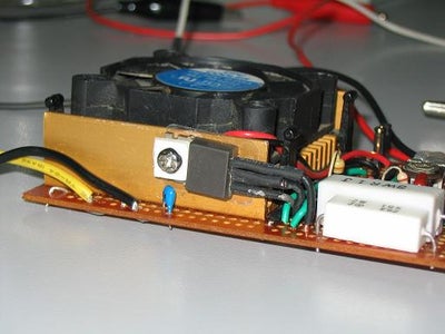

For the fast charge process you will need a high current , in this case you should use a heat sink, i have used a fan with its heat sink from an old VEGA card. it worked perfectly. the circuit can handle currents up to 3A.
- I fixed fan module to the PCB.

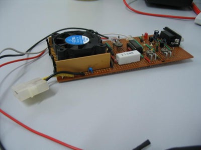

Step 4: Fixing the MOSFET
The transistor should have a very strong thermal contact with the heat sink, i fixed it to the back of the fan module. as shown in the image below.
BE CAREFUL, DON'T TO ALLOW THE TRANSISTOR TERMINALS TO TOUCH THE BOARD.
Step 5: Soldering the Components
Then i started to add the components one by one.
I hope that i have time to make a professional PCB, but that was my first version of the project.

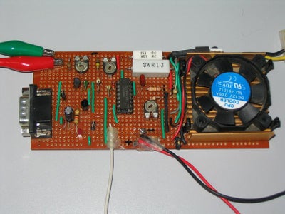

Step 6: The Complete Circuit
This is the final circuit after adding all the components
look at the notes.
Step 7: Mounting the Discharge Transistor
This is a closed image showing how i mounted the discharge transistor.

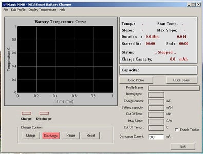

Step 8: The Program
A screen shot of my program
I'm working on uploading the software ( it's big )

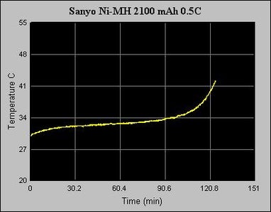

Step 9: Charging Curves
This is a sample charging curve for a Sanyo 2100 mAH battery charged with 0.5C ( 1A)
notice the dT/dt on the curve.
Note that the program stop the charging process when the battery temperature increases rapidly
slope equals ( .08 - 1 C/min )

    Hi.
    I think that your diagram is not well. First, the diode at pin 2 LM324 is turned. I think ,anode have to go at pin2 ,cathode at gnd to establish 0.6v at pin2.
    Second,I have 3 v to 4v at fan with slow moving ventilation.Which type of the fan I must use: at 5v ,or 12v?.When I put 82k resistor between VCC and the baseof the transistor (I put BC639 ) I have about 8v to 9v, but BC639 is just warmer(about 40 to 50 Celsius degree.Third , cooling fancontacts need to be turned (oposite).
    Fourth,100kOhm resistor at trimer 10kOhm#pin12 LM324,I think it should be there.Without 100kOhm , don't have current adjustment at all. With resistor ,have
    current range from 0 to 0.65 A max..Why is that?.And,finally , In software you have a bug when I turn CHARGE button, next PAUSE,and again CHARGE button the program says '55 error' and close the program.
    Best Regards from Serbia-Belgrade
