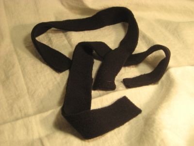

Strips of polar fleece 1" wide.

Cut a strip of polar fleece 1"x 60",(x2 for the other hand). This does not have to be in one piece. 3 x 20" works fine.
Now you can start lacing your polar fleece through the punch holes.
Start at the top of the bar between the thumb and fingers. Once you lace it through the hole, wrap the fleece downward around the bar 5 or 6 times (figures 2,3,4) to make it nice and padded and no bottle edges are showing.
Start lacing by bringing the end of the fleece through the next hole from the back side and loop it around to the back again and repeat.
Now you can lace all the way around the perimeter. When you get to the neck and run out of holes, wrap through the neck opening 3 or 4 times and continue lacing on the other side of the neck, till you join up at the bottom of the thumb hole.
Lace around the bottom and your done. The ends are easily tucked into your previous stitch.
