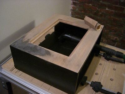

I used sandpaper to sand off all the old paint. I was paranoid that the old paint was somehow toxic so I had my HEPA filter running and used my dust extractor to get all the dust out of the way.
I painted the piece with black casein paint which is made from milk. I didn't make it myself this time, but maybe I will next time.
