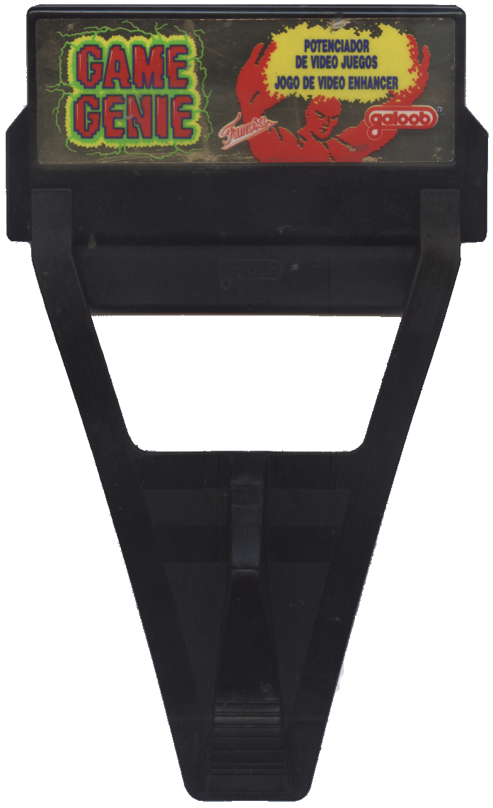

4) Game Genie 72 pin connector or equivalent.

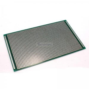

5) Perf Board
• You will need this to create circuits, LED array and to mount the 72 pin cartridge connector.

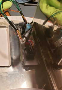

Once you determine that everything will fit into the toaster, the next step is figuring out where to mount the 72 pin cartridge connector.
Use your tin snips/aviation snips or whatever tools you have and remove any metal, heating elements or anything that my get in the way. Try not to remove too much, you may need to keep some items to mount things to.
Put a game cart on top of the perf board to see how much of the game you want showing from the top of the toaster. Measure and measure again, then mark where you want it. I then made these brackets for the board to rest on, then held them in place with epoxy.
Next, you need to fit the game genie connector to the perf board. This was probably the second most tedious and difficult part of the build so far. You have to bend and fan out the pins to make them line up on the perf board. If you're not paying attention, you can break a pin off when trying to slide the connector onto the the board. Like I did. Luckily, I was able to cut into the connector and solder in a piece of copper wire to act as a new pin. I got lucky, so be careful!

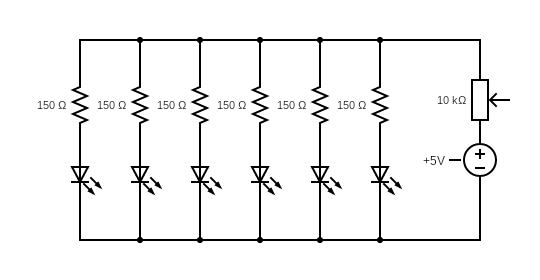

I used Orange LEDs with 2.2 forward voltage. I wired all 6 in parallel, then wired it through the potentiometer to control the brightness. I provided a schematic of what I did.
For these LEDs, I had to use 150 ohm resistors. I then soldered everything to a piece of perf board and used epoxy to mount it. I placed a couple pieces of Kapton tape behind the array to make sure it doesn't short to the chassis.
Since there was room on the perf board where the cartridge connector is mounted, I soldered each LED on to that as a base. Then mounted two other LEDs on their own mount.
