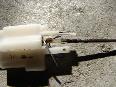

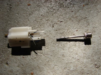

First of all get a refilable lighter and take it apart so that you are left with the just gas chamber. most refilable lighters have a small tube that comes off it, you need this in order to make this.
get the lighter and the inflater adapter and carefully insert the adapter inside the small tube. sometimes the adapter may be to thick to get inside the lighters tube, if so just file it down to make it thinner.

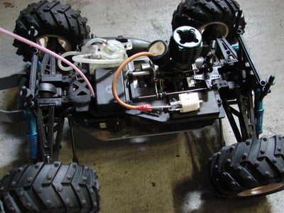

this is slightly tricky because you have to line things up right and it can get hard.
basically you can see the servo arm moves as you pull the trigger on the control. you have to put the lighter on it so that when it moves it will push lighters arms and release the gas. Once you have done so you have to secure it down. make sure its not near anything that will get hot(eg the engine) otherwise you may have an unexpected explosion, lol.

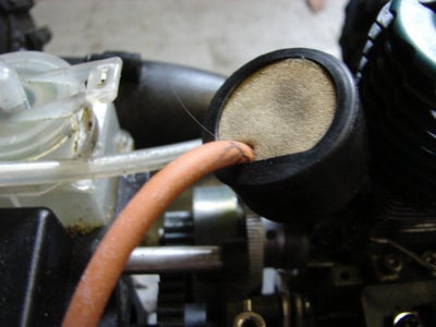

once you have sucured it down, just put the other end of the rubber tube in the air filter (you might want to tape it in place, don't block air flow).

now its fitted it should give a boost once you press the trigger all the way.
i would not recomend doing this because its bound to blow somthing up.
i havent actually tried it yet so i dont no what the outcome will be, but i dont really mind as i dont use my rc car much anymore.
it takes a while for all the gas to get sucked up so i would do this in a big open area.

    THIS IS NOT A BOOSTER KIT!!!!!! THIS WILL NOT ALLOW YOU TO GAIN ANY SORT OF POWER, because your just injecting more fuel into the engine ,which just makes it super rich. Instead of giving more power it will even decrease power. what you need is a oxidizer, a compound that give out oxygen. such as nitrous oxide (no2), or hydrogen peroxide etc... this is so because the oxygen in contact with the fuel allows a more powerful burn, which increases the the horsepower of the engine.

    i dont know a lot about cars like this as i use electric ones, but wouldn't that cause damage to both the engine and air filter? air filters aren't suposed to have liquids in them, thats what the covers are for, right?

    i have done this. also i injected the intake with Butane from just a lighter, opened all the way up, to all the way down. here is what i learned : gas's such as butane, which is in lighters, lights at a particular mixture with air and heat. engines in a RC engine don't get anything close to these requirements. thus, it pretty much did nothing except make the engine run like crap, i mean puttering, missing and just stopping all together. butane, when expanded from a liquid form to a gas form, creates Cold. nitro engines, Must keep a particular temp to continue to run, under by 5 degrees, and no go. if its over by 5, you'll over heat by compounding affects. when mixing butane gas in larger volumes, you tend to cool the intake, which in turn, cools the entire engine, and thus causes the nitro not to fire off. all in all, would work great, if we had a GAS, or liquid which could Help nitro instead of hinder it.. but again, anything you do to HELP your engine run, will only make it run HOTTER.. which in turn causes BAD things to happen. just my experiences with nitro engines and trying to Boost them. great build, i give 2 thumbs up for creative thought on how to use the lighter valve with a servo..
